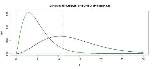

The figure below shows the PDF of the central chi-squared distribution $Chisq(\nu = 5)$ for a fair die (green), and the noncentral chi-squared distribution $Chisq(\nu =5, \lambda=8.2)$ for your dishonest die (blue). You can see that about half the area under the latter curve is to the right of the critical value $q^* = 11.07.$
