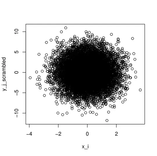

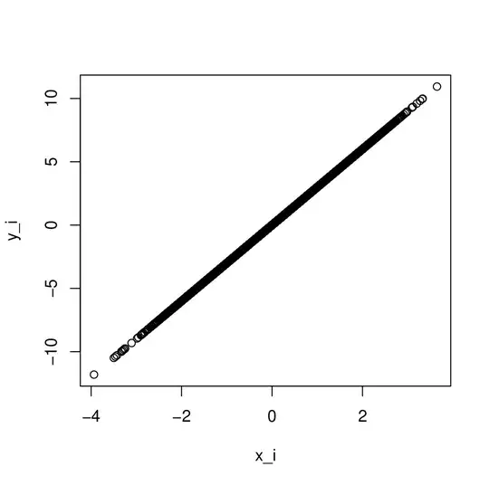

Wanted to add an additional answer to Jason Kang's question in the comments. We know that $x_{i\neq j}$ and $y_j$ have 0 covariance.
Take it this way Suppose we had $X$ be drawn from a normal. Say $Y = 3 X$. We have perfect correlation, right? Yes, but not between any $x_i, y_j$. $y_j = 3 x_j$, but $y_j \neq 3 x_{i\neq j}$. If I jumble the order of the $y$'s, I will get $0$ correlation.
One can see this from viewing a plot:
> library(data.table)
> tabl <- data.table(x = rnorm(10000))
> tabl[,y:=x*3]
> plot(tabl$y~tabl$x, xlab = "x_i", ylab = "y_i")
> plot(sample(tabl$y,10000)~tabl$x)
Daycent
