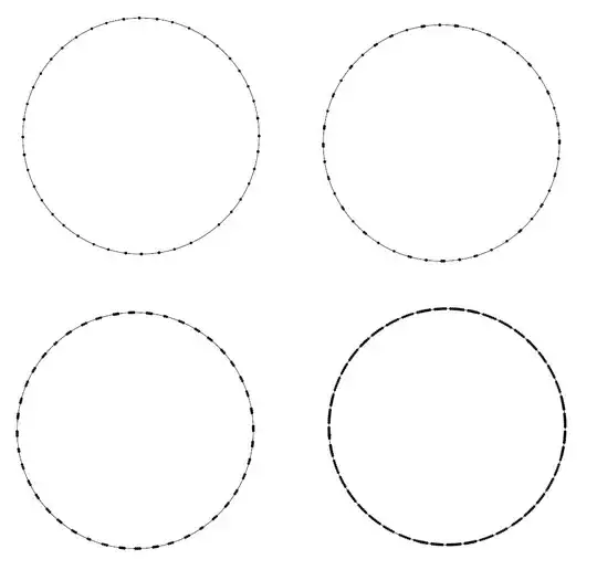

  • $\pi$ is irrational iff the orbit of $(1,0)$ under rotations of angle $1$ is dense in the circle; so maybe you can convince someone that $\pi$ is irrational by drawing approximations of this orbit (of course, it is not a proof). – Seirios Sep 23 '12 at 09:29
  • @Seirios Sorry, I'm not getting you. A figure maybe? – user13107 Sep 23 '12 at 09:37

I developp my comment: Take the point $x_0=(1,0)$ on the unit circle $S^1$; if $R$ is the rotation of one radian around $(0,0)$, let $x_1=Rx_0$, $x_2=Rx_1$, $x_3=Rx_2$ and so on.
In complex notation, you have $x_n=e^{in}$. If $\pi$ is rational, there exist $p,q>0$ such that $\pi=p/q$ and so $x_{2p}=e^{i2p}=e^{i2q\pi}=x_0$; thus, $\{x_n, n \geq 0\}$ is discrete in $S^1$. Otherwise, $\{x_n,n \geq 0\}$ is dense in $S^1$, ie. it seems to cover the circle.
Consequently, you can convince someone without calculus that $\pi$ is irrational by showing that $\{x_n, \geq 0\}$ seems to cover the circle; of course, it is not a proof.
Here are some iterations:
Density in the circle
