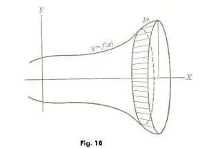

When calculating the surface area of a surface of revolution, we derive the formula $$S = \int_a^b 2\pi f(x) ds$$ by approximating the surface by a set conical loops (for lack of a better term). Then we take the limit as the width of those loops goes to zero and get the surface area. That makes perfect sense.
But why couldn't we approximate the surface by cylindrical loops (I hope you guys understand what I mean by that)? To me this seems like the more Riemann style way to do it -- where the usual method looks a lot like the trapezoidal method for evaluating integrals. But in the limit as $\Delta x \to 0$, shouldn't the error of either way also go to zero?
Why would $\int_a^b 2\pi f(x) dx$ get you the wrong answer?

This is a lot like trying to approximate the length of a hypotenuse of a right triangle by just adding up only the horizontal legs of small right triangles which fit together to make the larger right triangle. One clearly needs to add up the hypotenuses of the small right triangles in this case, not just the horizontal legs.

    No I just thought about it more and realized why approximating the area under a curve by rectangles can be used to bound the area from below and from above. But in the case of the surface area of a surface of revolution, using only the horizontal part of the length of a loop will bound it from below, but there's no reason to think that in the limit it will converge to the actual surface area. I've still got a bit more to think about it to see why it definitely won't converge to the correct answer, but at least I see the distinction now and can see that I shouldn't expect it to do so. – Bobbie D Nov 14 '16 at 00:55
  • Bobbie-- Note that using rectangles above wouldn't give an upper bound for the surface area, just a shifted version of using the areas using rectangles below via a different partition. Maybe look at a simple case like a cone via revolving $y=cx$ for $x \in [0,a]$ about the $x$ axis. In that case we have a known formula for the area (surface area of cone), and can compare with results of various integral versions relatively easily. – coffeemath Nov 14 '16 at 01:05
  • Yeah, that's what I was trying to say. My reasoning for thinking that I could use $dx$ instead of $ds$ was by making an analogy to regular Riemann sums. But I realized that the area under a curve can be bounded above and below (and in the limit they converge to a single number) while the surface area of a surface of revolution can only be bounded below using $\Delta x$'s. And because it's only bounded from below there's no guarantee that $\Delta x\to 0$ will converge to the correct limit. – Bobbie D Nov 14 '16 at 01:08
You can think $ds$ as: \begin{equation} ds=\sqrt{(dx)^2+(dy)^2)}\\ ds=\sqrt{(dx)^2(1+(\frac{dy}{dx})^2)}\\ ds=dx\sqrt{1+(\frac{dy}{dx})^2}\\ ds=dx\sqrt{1+(\frac{df}{dx})^2} \end{equation} just applying Pythagoras's theorem.
The term inside the square root takes into account the slope of the curve; in the case $\frac{df}{dx}=0$, $ds$=$dx$ (it could be the case of a cylinder along x-axis).
