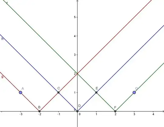

Hint: What is the connection between the broken line ABCDEFG and your problem?
What do you think for example in point B of the left derivative versus the right derivative?

You can rewrite the function as follows:
1) On $]-\infty,-2], f(x)=f_1(x)=-x-2$
2) On $[-2,-1], f(x)=f_2(x)=x+2$
3) On $[-1,0], f(x)=f_3(x)=-x$
4) On $[0,1], f(x)=f_4(x)=x$
5) On $[1,2], f(x)=f_5(x)=-x+2$
6) On $[2,\infty[, f(x)=f_6(x)=x-2$
On each of the open domains, the function is linear and therefore differentiable.
At each of the "intermediate points" {-2,-1,0,1,2} the function is not differentiable (left and right limit of the derivative are different). For example, $f'_1(x)=-1$ and $f'_2(x)$=1, so that $\lim_{x \to -2^-} f'(x)=-1 \neq \lim_{x \to -2^+} f'(x)=1$
