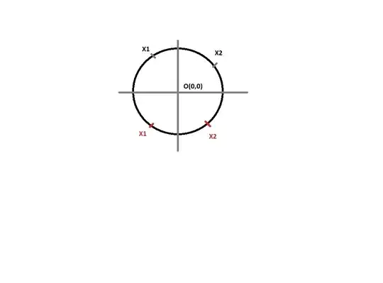

If $X_{1},X_{2}$ are points on the unit circle and a third point $X_{3}$ is chosen then it will not be located on any semicircle that contains $X_{1}$ and $X_{2}$ if it falls on the smallest arc connecting the two mirrorpoints of $X_{1}$ and $X_{2}$ with respect to the origin.
Denoting this arc by $A\left(X_{1},X_{2}\right)$ and its length by $\left|A\left(X_{1},X_{2}\right)\right|$ we find that $\left|A\left(X_{1},X_{2}\right)\right|$ has uniform distribution on $\left[0,\pi\right]$.
The probability that for $X_{1},X_{2},X_{3}$ there is no semicircle that contains them equals:
$$\int_{0}^{\pi}\Pr\left(X_{3}\in A\left(X_{1},X_{2}\right)\mid\left|A\left(X_{1},X_{2}\right)\right|=u\right)\frac{1}{\pi}du=\int_{0}^{\pi}\frac{u}{2\pi}\frac{1}{\pi}du=\left[\frac{u^{2}}{4\pi^{2}}\right]_{0}^{\pi}=\frac{1}{4}$$

  • I've added an image in the above question , referring to that , are you suggesting that the three points would not lie on the same circle if the third point lies in the arc between $X1$ and $X2$ (Red ones) ? – User9523 Oct 19 '16 at 07:37
  • Yes. That's exactly what I meant to say. Only the red $X_1$ should carry the name $X_2$ (as mirror of the black $X_2$ with respect to the origin) and vice versa. – drhab Oct 19 '16 at 07:44
