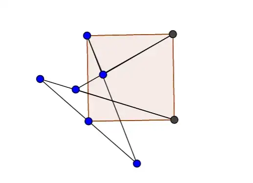

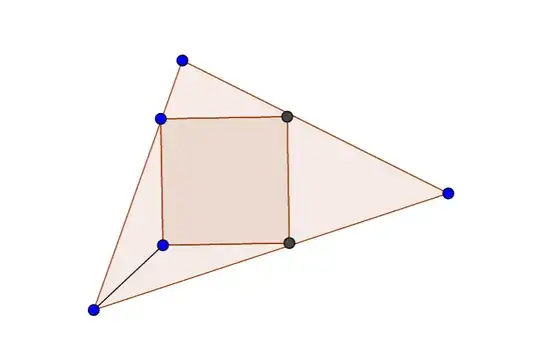

Here is a sketch of proof :
Let's try to find a triangle $T$ with minimum area that covers unit square.
First, we can assume each 3 sides of $T$ have to contain at least one of vertices of square. (If not, we can move side more close to square and this gives new triangle with smaller area)
enter image description here Second, if a vertex $v$ of square lies on a side $AB$ of $T$, then $v$ is midpoint of $AB$. This is not hard to prove.
(Here $M$ is midpoint of $AB$, and area of $MBB'$ is bigger than $MCC'$. (Consider a line $BD$ which is parallel to $AC$.)
Third, by the first assumption, we can find 3 vertices of square which forms a right angle. By the second property, $T$ should be right triangle. By the second property again, $T$ should be isosceles right triangle, which has area $2$.
(Here $M, N, P$ are midpoint of $BC, AC, AB$. Then $MP$ (resp. $MN$) is parallel to $AC$ (resp. $AB$), so angle $\angle BAC$ should be right angle, i.e. $Q=A$.)

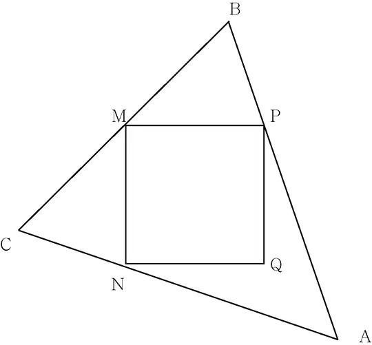

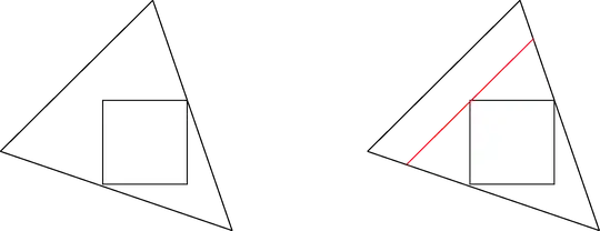

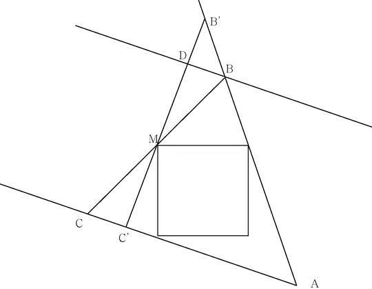

Here is a nice proof: however the triangle is drawn, we may first bring in its edges (decreasing the area) until each of its $3$ edges go through a different vertex of the square:
From here, cut a line from the final vertex of the square to the vertex of the triangle:
Now simply fold over each of the four triangles. No matter what, the four folds collectively cover the square, proving the triangle has area at least $2$.
It remains to show: why do these four folds cover the square?
This is simpler than I thought. Let the square's vertices be $A, B, C, D$, such that in the above figures $A$ is bottom-left, $B$ top-left, $C$ top-right, $D$ bottom-right. Also refer to the four triangles that are folded over as the "left", "right", "top", and "bottom" triangles. When reflected across the sides of the square, the four triangles' boundaries inside the square lie on only 3 line segments, one each from vertices $B$, $C$, and $D$. Let the lines from $B$, $C$, $D$ be called $l, m, n$, respectively.
Suppose towards a contradiction that there is a point not covered by the four reflected triangles. To not be covered by the reflection of the left triangle, it must be above $l$. To not be covered by the reflection of the top triangle given that it is above $l$, it must be below $m$. To not be covered by the reflection of the right triangle given that it is below $m$, it must be below $n$. But if it is below $n$ and inside the square then it is covered by the reflection of the bottom triangle. Contradiction, so no such point exists.

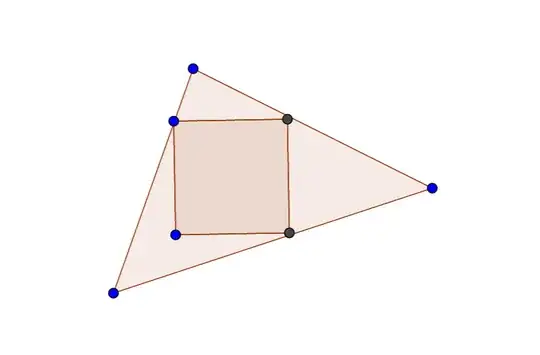

Intuitively when vertices of square $S:=v_1v_2v_3v_4$ of side length $1$ are in sides of triangle $T=\Delta\ ABC$, then ${\rm area}\ T$ is smallest
Notation : Edge $xy$ is $[xy]$ And length of edge $xy$ is $|xy|$
Here we have two cases :
(1) $ v_1\in [AB],\ v_2\in [AC]$ and edge $[v_3v_4]$ is in edge $[BC]$
(2) $v_1\in [AB],\ v_2\in [AC],\ v_3\in [BC] $ That is $v_4$ is in interior of $T$
Consider case (1) : Consider a reflection point $A'$ of $A$ wrt edge $[v_1v_2]$
(1.1) Assume that $A'$ has distance larger than $1$ from $[v_1v_2]$
Define $$ [A'v_1]\cap [BC]:=\{ v_4'\},\ [A'v_2]\cap [BC]:=\{ v_3'\} $$
so that $$ 2{\rm area}\ S +2 {\rm area}\ \Delta\ A'v_3'v_4' ={\rm area}\ T $$
(1.2) Assume that $A'$ has distance smaller than $1$ from $[v_1v_2]$
If line $v_1 + t(A'-v_1)$ meets at $v_4'$ with $BC$, then note that $$ {\rm area}\ \Delta A'v_1v_2={\rm area}\ \Delta Av_1v_2 $$
$$ {\rm area}\ \Delta v_1Bv_4 ={\rm area}\ \Delta v_1v_4 v_4' $$
$$ {\rm area}\ (S- \Delta A'v_1v_2-\Delta v_1v_4v_4' )< {\rm area}\ \Delta v_2Cv_3 $$
Consider case (2) : WLOG assume that $[Av_2]<[v_2C]$
(2.1) Now consider $A'$ has distance larger than $1$ from $[v_1v_2]$
Note that $\Delta v_2 A' v_2'$ contains $v_3$ where $$ v_2'\in [v_2C],\ |v_2v_2'|=|Av_2| $$
Here $[v_2v_3]$ is angle bisector of $\angle A'v_2v_2'$ so that $\overrightarrow{v_2'v_3}$ enters into square So $Cv_3$ enters into square This contradicts to definition of $v_3$
(2.2) Assume that we have $A'$ in interior of the square $S$
Define $$ v_1'\in [v_1B],\ |v_1v_1'|=|Av_1| $$
$$ v_2'\in v_2C,\ |v_2v_2'|=|Av_2| $$
$$v_3'\in [Bv_3],\ |v_3'v_3 |=|v_3v_2'| $$
Note that $Av_1'v_4v_3'v_3v_2'$ has area $2$
