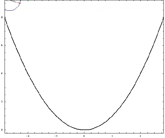

So the theorem is expressing an equivalent condition for rolling. Simple versions of the theorem are rolling of a circle over a straight line, inclined line, another circle, ellipse or parabola (See the animation below). Taking a look at the links will help you to visualize better. Without loss of generality you can assume that curve $2$ is still and curve $1$ is rolling on it.

This animation is made by J. M. and is included for better visualization.

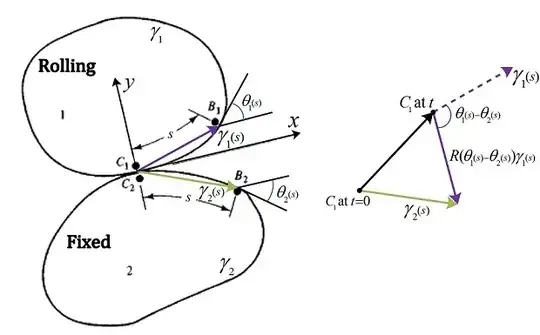

First place the two curves so that they are in contact at the origin, with body #2 as in step 1. Let $s$ be the (signed) arclength parameter as measured from the origin, with $\gamma_2$ the curve for body #2 and $\gamma_1$ the curve for body #1. Let $\theta_i = \theta_i(s)$ be the functions defined by $$ \tan \theta_i(s) = \text{slope at } \gamma_i(s) $$ Note that by our normalization $\gamma_1(s) = \gamma_1(s) - \gamma_1(0)$ is the vector to move from $\gamma_1(0)$ (which is the origin) to $\gamma_1(s)$. (See the graph in the image above)
Then the position of the relevant point $C_1$ on body #1 as you roll can be parameterized by
$$ \gamma_2(s) - R(\theta_1(s) - \theta_2(s))[\gamma_1(s)] $$
where $R(\theta)$ denote a clockwise rotation by angle $\theta$. In fact, we do a translation by $\gamma_2(s)$ and then a clockwise rotation by $R(\theta_1(s) - \theta_2(s))[\gamma_1(s)]$ to obtain the current position of $C_2$. The amount the graph $\gamma_1$ has rotated is exactly $\theta_1 - \theta_2$ [notice that we take the signed angle so $\theta_2 < 0$ in the illustration].
Since $\theta_1(0) = \theta_2(0) = 0$ by assumption, and that $\gamma_1(0) = 0$, you have that the derivative of the above function, evaluated at $s = 0$, gives
$$ \dot{\gamma}_2(0) - \dot{\gamma}_1(0) = (1,0) - (1,0) = 0.$$
where $\dot{\gamma}$ is the derivative with respect to $s$.

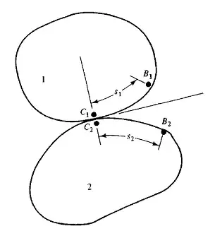

  • I added a crude illustration. Someone better at animations can probably make a cool gif explaining the formula, absent that I explained the picture in more words. Hope that helps. // Yes, $R$ is the rotation operator. (The one turning in the correct direction for the argument to work.) – Willie Wong Oct 19 '16 at 19:11
  • And yes, sorry for not being clear: the "point of contact" in Step 1 refers to the one specific point whose velocity we will analyze. I added a clarification. – Willie Wong Oct 19 '16 at 19:13
    @H.R.: yes. In the discussion above $\gamma_1(s)$ (or in reality, $\gamma_1(s) - \gamma_1(0)$) measures the displacement from a point ($\gamma_1(0)$) to the curve. Replace that by $v(s)$ measuring the displacement from your arbitrary point to the curve. Similarly, this displacement is measured when your body has a particular orientation. You need to find the angles $\theta_1$ (the angle that the body has turned) and $\theta_2$ (the angle that the other body has turned) as functions of $s$. Then $\gamma_2(s) - R(\theta_1(s) - \theta_2(s)) v(s)$ should do the trick. – Willie Wong Oct 19 '16 at 20:37

  • @H.R. thanks for the new illustration: much prettier than my hand-drawn one. – Willie Wong Oct 21 '16 at 13:27
