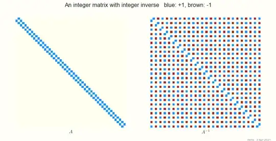

Just a comment, a picture of a particularly simple one:
Added:
Iterative solvers have a hard time solving $Ax = b$ with $b$ a point source $[0 0 0 ... 1 ... 0 0 0]$:
$A^{-1} b$ has to pick out a column of $A^{-1}, \pm \, [1 \, 0 \, -1 \, 0 ...]$. Also, this $A$ is far from positive-definite -- its eigenvalues are symmetric about $0$.
