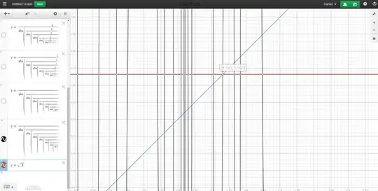

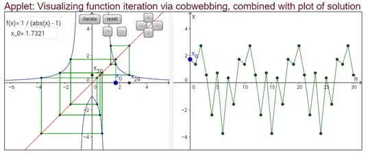

EDIT: this is an interesting visualisation for the $\sqrt{3}$ case (see figure 1)

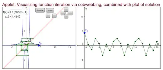

EDIT 2: this is another interesting discovery, if i put $f(x)=x$ for n iterations in a graphing calculator and record all of the points where the graph $y=x$ intersects the other graph, all of these points are the values of $x_0$ which are periodic of period n (see figure 3, i have written the equation for 9 iterations and found a fixed point at $\sqrt{3}$).
I also notice that the number of fixed points appears to be getting much larger each time, and these fixed points are particularly dense around the golden ratio phi and this might indicate that after an arbitrarily large number of iterations, we have an arbitrarily large number of fixed points, though I don't know if this would cover all algebraic numbers . However, some other values for $x_0$ may not themselves be periodic, but eventually reach one that is e.g. $3+\sqrt{2}$ (see figure 2)
figure 1 (figure 1)
figure 2 (figure 2)
figure 3 (figure 3)
