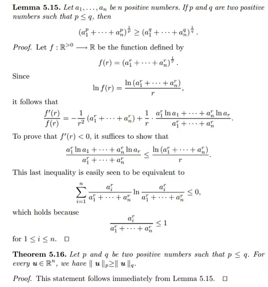

For vector p-norm defined as $(∑_{i=1}^n x_i^p )^{\frac{1}{p}}$ for any $p\ge 1$ and vector ${\bf{x}}=\{x_1,...,x_n\}$. The following proves it is decreasing with respect to $p$ by taking derivative (you don't need to read the whole proof, just have a look),
However, I am thinking if there is another approach without using the derivative. Is there any proof for monotonicity of p-norm without using derivatives? The upper bound can be proved by Holder's inequality by Relations between p norms

  • Correct me if I'm wrong, but I believe there is an error in the proof from your book. Specifically, the derivative looks to be incorrect. I believe it should be $\frac{f'(r)}{f(r)} = -\frac{1}{r^2}\ln(a_1^r+\cdots+a_n^r)+\cdots$. The error is the lack of the natural log in the book proof. – BSplitter Jan 16 '18 at 20:53
  • Also, I believe the second to last line is incorrect as well. It appears that numerator of the natural log argument should be $a_i$ instead of $a_i^r$, unless I'm missing something. – BSplitter Jan 17 '18 at 22:37
