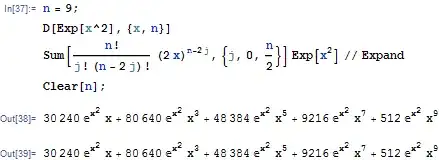

Here is a less elementary solution.
We consider the exponential generating function
$$G(t,x) = \sum_{n=0}^{\infty} \frac{t^n}{n!} \frac{d^n}{dx^n}e^{x^2}.$$
Then we can identify this series as the McLaurin series of $e^{(x+t)^2}$ near $t = 0$. Thus we must have
$$G(t,x) = e^{(x+t)^2} = e^{x^2} e^{2xt} e^{t^2} = e^{x^2}\left( \sum_{k=0}^{\infty} \frac{(2x)^k}{k!} t^k \right)\left( \sum_{l=0}^{\infty} \frac{1}{l!} t^{2l} \right). $$
Expanding this series and comparing, we have
$$ \frac{d^n}{dx^n} e^{x^2} = \left( \sum_{j=0}^{\lfloor n/2 \rfloor} \frac{n!}{j!(n-2j)!}(2x)^{n-2j} \right) e^{x^2}. $$
Here is an example:

1I love this, particularly because my intuition was that a closed form expression using only simple operations like factorial would not be possible. – 2'5 9'2 Sep 10 '12 at 18:46
It would be even simpler to use the Hermite polynomials for this, no? – J. M. ain't a mathematician Sep 12 '12 at 02:22
@J.M., Unfortunately I know not much about the Hermite polynomials. I have heard of these polynomials, and also know that they are closely related to the Gaussian-weighted $L^2$ space, but the important thing is that I even do not know the exact definition or a representation formula for this nice family. That's why I just made a rather elementary approach. – Sangchul Lee Sep 12 '12 at 02:37
2In that case, you'll want to see the Rodrigues formula for the Hermite polynomials. Notice anything? ;) – J. M. ain't a mathematician Sep 12 '12 at 02:42
2@J.M., Now it's also clear to me! We may write $$\frac{d^n}{dx^n}e^{x^2} = i^{-n}H_n(ix)e^{x^2}.$$ – Sangchul Lee Sep 12 '12 at 02:46
