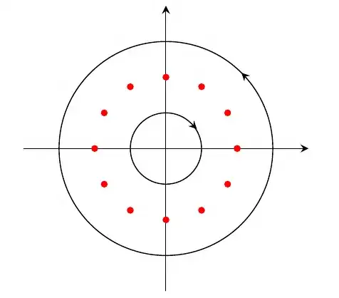

This integral remind me of Matsubara sum. Let me use contour integral to provide another perspective of the case $t = 2s$.
Define $a_n = \sum_{k = 1}^{n-1} \sin ^{t} \left( \frac{\pi k }{n} \right) $. What OP is looking for is \begin{equation} \sum_{k=1}^{n-1} \sin^{t} \left( \frac{\pi k }{2n} \right) = \frac{1}{2} \left( \sum_{k=1}^{2n-1} \sin^{t} \left( \frac{\pi k }{2n} \right) -1 \right) = \frac{1}{2} ( a_{2n } - 1 ) \end{equation} One can extend the summation to all the roots of $\zeta^{2n} = 1$ if $t = 2s$ \begin{equation} a_n = \frac{1}{2} \sum_{k=1}^{2n} \sin^{2s} \left( \frac{\pi k }{n} \right ) = \frac{1}{2} \sum_{ k = 1}^{2n} f( \zeta_k ) \qquad \zeta_k = \exp( \frac{ik\pi }{n}) \end{equation} where \begin{equation} f(z ) = \left( \frac{z - \frac{1}{z}}{2i} \right)^{2s} \end{equation}
The summation can be regarded as the sum of the residue of the follow contour integral \begin{equation} \sum_{ k = 1}^{2n} f( \zeta_k ) = \frac{2n}{2\pi i }\oint_{C} \frac{z^{2n-1}}{ z^{2n} - 1} f( z) dz \end{equation} where the integrand is specifically designed such that \begin{equation} \text{Res} ( \frac{ 2n z^{2n-1}}{z^{2n} - 1} f(z) , \zeta_k ) = 2n \frac{z^{2n-1}(z - \zeta_k)}{z^{2n} - \zeta^{2n}_k} f(\zeta_k ) \Big|_{z = \zeta_k } = f(\zeta_k ) \end{equation} Here the closed contour should enclose all $\zeta_k$ but avoid the singularities of $f$, which can be taken as two concentric circles as shown in the following figure(red spots are those roots $\xi_k$).
The inner contour gives (minus) the residue at $0$, and the outer contour gives (minus) the residue at $\infty$, hence \begin{equation} \begin{aligned} a_n &= n \left[ -\text{Res}( \frac{z^{2n-1}}{ z^{2n} - 1} f( z) , 0 ) - \text{Res}( \frac{z^{2n-1}}{ z^{2n} - 1} f( z) , \infty ) \right] \\ \end{aligned} \end{equation} Convert the residue of $\infty$ to $0$ \begin{equation} \begin{aligned} a_n =& n \left[ \text{Res}( \frac{z^{2n-1}}{ 1 - z^{2n} } f( z) , 0 ) + \text{Res}( \frac{\frac{1}{z}}{1 - z^{2n} } f( \frac{1}{z}) , 0 ) \right] \\ =& n \left[ \text{Res}( \frac{1}{z}\frac{z^{2n} + 1 }{ 1 - z^{2n} } f(z) , 0 ) \right] \\ =& n \left[ \text{Res}( \frac{1}{z} ( 1 + 2\sum_{k=1}^{\infty} z^{2nj} ) f(z) , 0 ) \right] \\ \end{aligned} \end{equation} Finally, expand $f(z)$ and extract the terms with power $0, -2nj, -4nj$ etc, \begin{equation} \begin{aligned} a_n &= n \frac{(-1)^s}{2^{2s}} \left( (-1)^s {2s \choose s } + 2 \sum_{0 < nj < s } (-1)^{s+ nj} {2s \choose s+nj } \right)\\ &= \frac{n}{2^{2s}} \sum_{ -s < nj < s } (-1)^{nj} {2s \choose s + nj } \\ \end{aligned} \end{equation} This is the same as what @Sangchul Lee obtained.
