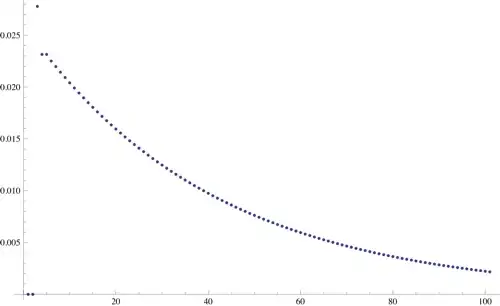

Distribution: Here is a plot of the probabilities of getting a double $6$ on a particular roll. I was surprised that the probability for both $3$ and $4$ rolls was $\frac5{216}$.
$\hspace{2cm}$
