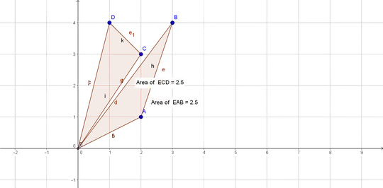

Here is a 2D example.
$$\begin{pmatrix} 2&3\\ 1&4\\ \end{pmatrix} \mapsto_{transpose} \begin{pmatrix} 2&1\\ 3&4\\ \end{pmatrix}$$
I'm still thinking of a satisfying (geometric) explanation as to why this always works, but pictures are always good.

  • I really like this picture. As for the geometric explanation, for the 2d case I think you might be able to use Heron's formula: https://en.wikipedia.org/wiki/Heron%27s_formula, specifically the version $A= \frac{1}{4} \sqrt{4 a^2b^2 - (a^2 + b^2 -c^2)^2}$. If we have a matrix $$M = \begin{bmatrix} m_1 & m_2 \ m_3 & m_4 \end{bmatrix}$$ then $a^2 = m_1^2 + m_3^2, b^2 = m_2^2 + m_3^2, c^2 = (m_2 - m_1)^2 + (m_4 - m_3^2)$. When we take the transpose $M^T=M'$, then in the formula for $A'$, we have $a^2= m_1^2 + m_2^2, b^2 = m_3^2 + m_4^2, c^2 = (m_4-m_2)^2+(m_3-m_1)^2$. – Chill2Macht Sep 06 '16 at 23:49
  • Clearly for both triangles $a^2 + b^2$ is the same, although $c^2$ is not. However, the term $4a^2b^2=(2ab)^2$ compensates exactly for the difference. – Chill2Macht Sep 06 '16 at 23:51
