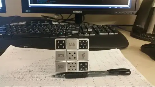

I know that there are mathematical descriptions of the Rubik's Cube based on finite group theory. And as far as I know those descriptions deal with just coloured tiles. Suppose however that in addition to the typical colourings the cube has letters (or markings similar to dice) applied to each tile and those letters are orientable. So that a correct solution to the cube not only requires you to match that correct coloured tiles to form a monochromatics face but also requires that every face have its letters in the same orientation.
How does orientation change our group theoretic description of the cube?
I am not certain if there is a better way to describe these cubes. It is a two years work anniversary gift.

Bear in mind however, the centre square of your cube shown in the picture does not have a distinguishable orientation.
