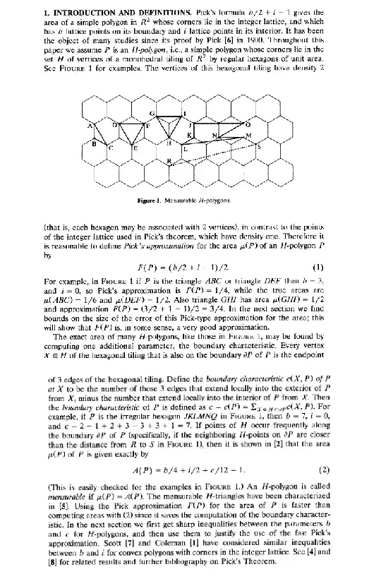

The things that remains a puzzle to me is what is meant by the 'boundary characteristic'. The authors introduce this parameter as the "number of edge extended locally into the exterior of P minus those extended locally into the interior of P", where P is the polygon in question. Can anybody help explain this more thoroughly, ideally with a simple example?

EDIT: Here is the relevant part of the paper I am talking about: enter image description here

We can just use the example $P = JKLMNQ$ given in the paper. The first term $c(J, P)$ is $2$. Why? Look at the three edges in the lattice coming out from $J$. Two of them are completely outside $P$, while the last one $JK$ is neither inside nor outside. Thus, $c(J, P) = 2 - 0 = 2$.
The next term $c(K, P)$ is $-1$. In this case, $KJ$ and $KL$ are neither inside nor outside, and the other edge is inside $P$. So $c(K, P) = 0 - 1 = -1$. Note that the last edge is not completely inside, but we are only looking at its behavior very close to $K$, so it still counts as inside.
You continue doing this for all boundary lattice points of $P$, and adding them up gives you $c(P)$.
