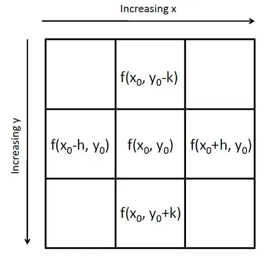

Let us now turn to 2D. Consider a 2 variables function $f(x,y)$, discretized as shown on the graphics below, i.e., with discretization steps $h$ (resp $k$) along the $x$ (resp. $y$) direction.
Using (1), a discrete analog to $\Delta f$ is, by taking $h=k$ for simpler computations:
$$\Delta f(x_0,y_0)\approx\dfrac{f(x_0+h,y_0)-2f(x_0,y_0)+f(x_0-h,y_0)}{h^2}+\dfrac{f(x_0,y_0+h)-2f(x_0,y_0)+f(x_0,y_0-h)}{h^2}$$
$$\tag{2}\Delta f(x_0,y_0)\approx\dfrac{f(x_0,y_0+h)+f(x_0,y_0-h)+f(x_0+h,y_0)+f(x_0-h,y_0)-4f(x_0,y_0)}{h^2}$$
Now, let us express that the Laplacian operator is zero:
$$\Delta f(x_0,y_0)=0\Longleftrightarrow$$ $$\Longleftrightarrow f(x_0,y_0)\approx\dfrac{1}{4}\left(f(x_0,y_0+h)+f(x_0,y_0-h)+f(x_0+h,y_0)+f(x_0-h,y_0)\right)$$
i.e., at such a point, the central value is the average of its neighboring values, as in the 1D case.
This representation connects the fact that the Laplacian is zero whenever we are at an equilibrium point.
