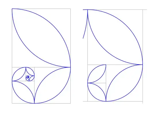

By now you know very well how to determine the Fibonacci numbers for negative indices, albeit by the recursion formula or the Binet formula as well as various others. My contribution is to show you what it looks like. The figure below is my crab-claw spiral; it consists of a Fibonacci spiral for $f_{-32}:f_{32}$. The image on the left is the complete spiral, that on the right is a detail at approximately $10^6$-fold zoom. The cusps are due to the alternating signs in the negative indices.
Crab-claw Spiral
