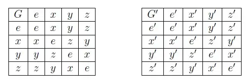

Let the group is $$G=\{e,a,b,c\}.$$ From Lagrange's theorem, the order of each element will divide 4. So, order fo any element will be either 2 or 4. If it is 4 then the group is cyclic. If for each element of the group $G$ order is 2 then it is isomorphic to $\mathbb{Z}_2\times \mathbb{Z}_2.$
We will prove 2nd part by showing that any two non-cyclic groups of order 4 are isomorphic to each other. For this, let us take any two non-cyclic groups of order 4, denote them by $ G $ and $ G^\prime $. Let $ e $ and $ e^\prime $ denote the identity of these groups respectively. Let $$ G=\{e,x,y,z\} $$ and $$G^\prime=\{e^\prime,x^\prime,y^\prime,z^\prime\}.$$ We must have $ x^2=y^2=z^2=e,\ (x^\prime)^2=(y^\prime)^2=(z^\prime)^2=e^\prime $. enter image description here
It is clear from the table that the map $$ \phi\ :\ G\to G^\prime $$ given by \begin{align*} \phi(e)& =e^\prime\\ \phi(x) & = x^\prime\\ \phi(y)& = y^\prime\\ \phi(z) & = z^\prime\ \text{is an isomorphism.} \end{align*}
