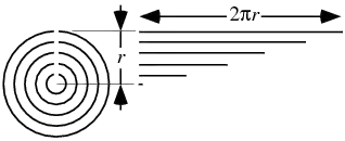

The above integral seems geometrically as below figure.
\begin{align} \int_0^r 2\pi r\, dr& = 2\pi\int_0^r\ r\, dr \\ & = 2\pi\bigg\lvert_0^r\ \frac{r^2}{2} \\ & = \bigg(2\pi \frac{r^2}{2}\bigg)-\bigg(2\pi \frac{0^2}{2}\bigg) \\ & = \frac{2\pi r^2}{2} \\ & = \require{cancel} \frac{\cancel{2}\pi r^2}{\cancel{2}} \\ & = \color{red}{\pi r^2} \end{align}

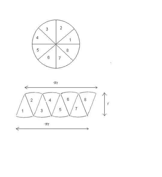

I would like to show you another method how we can prove that the area of circle is $\pi r^2$ by using infinity part of a circle. I divided only 8 parts in my picture to demostrate how to apply that method but we need to have infinite divided parts to get an exact rectangle shape. After that We can write easily that
Area of circle = $\pi r .r =\pi r^2$
enter image description here Note: I assumed that we know the circumference is $2πr$

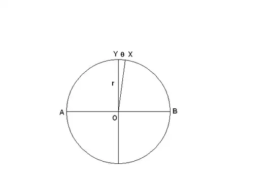

enter image description here Consider a circle of radius $r$ with $O$ as its center.
Now, consider an arc $XY$of the circle which subtends an angle of $\theta$ at the center.
let, $dA$ be the area of the segment $XOY$
if we take infinitesimally small angle $\delta\theta$ then we have, $dA=\frac{1}{2}(r^2)(\sin{\delta\theta})$
we know that $\lim_{\delta\theta ->0} \frac{\sin\delta\theta}{\delta\theta} =1$
using, the above fact, we have, $dA=\frac{1}{2}(r^2)(\frac{\sin\delta\theta}{\delta\theta})({\delta\theta})$
Now, $\lim_{\delta\theta ->0} dA = \lim_{\delta\theta ->0}\frac{1}{2}(r^2)(\frac{\sin\delta\theta}{\delta\theta})({\delta\theta})$
we, have, $dA=\frac{1}{2}(r^2){\delta\theta}$
Now,$$\int{dA}=\int_{0}^{2\pi}\frac{1}{2}(r^2){\delta\theta}$$
$$\int{dA}=\frac{1}{2}(r^2)\int_{0}^{2\pi}{\delta\theta}$$
$$A=\frac{1}{2}(r^2)(2\pi)$$ $$A={\pi}r^2$$
we, now have the area of a circle of radius $r$, and it is ${\pi}r^2$

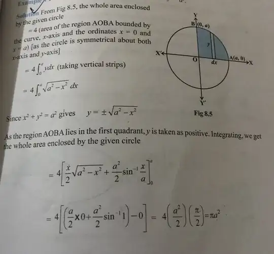

Consider the standard equation of circle $$x^2 + y^2 = a^2$$ where $a$ is the radius of the circle.
VIEW PROOF
