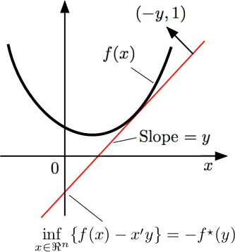

I'm going to attempt a very basic and intuitively understandable explanation. Of course this will be grossly oversimplifying things but I understand it's what was asked for.
The point of the convex conjugate is to represent a function $f$ as a set of tangent hyperplanes. The parameters of all the tangent hyperplanes are encoded in the convex conjugate function $f^*$.
Let's make things easier to understand by covering the 1D case. In that case our $f^*$ is called the Legendre transformation and our hyperplanes become simple lines. The generalization to multidimensional functionals is then relatively straightforward.
Here's the Legendre transformation:
$f^*(y)=\sup(yx - f(x))$
The domain of $f^*$ is slope values, the co-domain is y-offsets (as in a simple line equation $ax + b$). Hence $f^*$ encodes a set of lines. First we're going to evaluate $f^*$ at a single point $y$.
$f^*$ at a point $y$ is the largest difference value between $f$ and a line through the origin with slope $y$.
Note that this value might be still negative. In plain English, it's the degree to which $yx$ "surpasses" $f(x)$ in value. If your function $f$ goes "above" $yx$ (for example $f(x) = x^2+1$ and $y=0.5$) then the value $f^*(y)$ will be negative. If your function goes "below" $yx$ your value will be positive.
The "surpass value" is important because in the convex case it is one parameter of a tangent line to $f$: the y-offset.
To imagine $f^*(y)$ not just for a single value $y$ but for the entire domain, picture $f(x)$ and a line through the origin that's rotating around the origin, like a propeller. For each incremental rotation we plot the largest difference value between $f$ and the line into a new coordinate system (where $y$ may go along the x-axis and $f^*(y)$ may go along the y-axis). The resulting graph then shows the whole Legendre transformation of $f$.
The Wikipedia Article on Legendre transformations also has some more good information, such as:
If the convex function $f$ is defined on the whole line and is everywhere differentiable, then $f^*(y)$ can be interpreted as the negative of the y-intercept of the tangent line to the graph of f that has slope $y$.
So $f^*$ can be seen as a map where the input is a slope and the output is a y-offset in the coordinate system of $f$. Thus $f^*$ holds the information how much I need to offset a line with a particular slope such that it becomes a tangent to $f$. The set of all the lines offset in y by their respective amounts covers the area at and below $f$.
It's not too hard to imagine why that particular trick only works for convex functions.
PS: If $f$ is convex there is a much easier definition of the Legendre transformation which avoids the whole supremum thing:
$f^*(f'(x))=x*f'(x)-f(x)$
In plain English: For $x$ We compute $f'(x)$ and define $f^*$ at $f'(x)$ as the negative y intercept of the tangent line.
