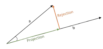

To understand that we need to understand orthogonal projection. First we consider the orthogonal projection of a vector $\vec v$ onto the one-dimensional subspace $\operatorname{span}(\vec u)$. It is defined to be the unique component -- denoted $\vec v_\|$ or $\operatorname{proj}_{\vec u}(\vec v)$ -- of $\vec v$ parallel to $\vec u$ such that $$\vec v = \vec v_\| + \vec v_\bot,\quad \vec v_\bot \cdot \vec u = 0$$
enter image description hereenter image description here
Before I give the formula, I'll give a geometric definition of the dot product that should make it much easier to understand where the formula comes from: the dot product $\vec v \cdot \vec u$ is the signed length of the projection of $\vec v$ onto $\operatorname{span}(\vec u)$ times the length of $\vec u$ where the sign is determined by the equation $\operatorname{proj}_{\vec u}(\vec v) = \lambda \vec u$ -- if $\lambda >0$, then the sign is $+$, otherwise it is $-$. For slightly more on this you can see this answer.
Then it should be easy to convince yourself that $$\operatorname{proj}_{\vec u}(\vec v) = \frac{\vec v\cdot \vec u}{\|\vec u\|^2}\vec u$$
(Note: don't take this as the definition of $\operatorname{proj}_{\vec u}(\vec v)$ or else we just get a circular set of definitions. The definition is in the first paragraph of this section -- this is just a formula for how to calculate $\operatorname{proj}_{\vec u}(\vec v)$)

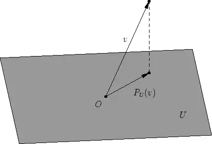

But we don't only want to project a vector onto a one-dimensional subspace -- often we want to project a vector onto an arbitrary-dimensional subspace $U$.
Once we have the one-dimensional orthogonal projection down, it's not too hard to extend it. Say we have an orthonormal basis $\{\vec u_1, \dots, \vec u_k\}$ for the subspace $U$. Then the orthogonal projection of $\vec v$ onto $U$ will simply be the sum of the projections onto each $\operatorname{proj}_{\vec u_i}(\vec v)$:
$$\operatorname{proj}_{U}(\vec v) = \sum_{i=1}^k \operatorname{proj}_{\vec u_i}(\vec v) = \sum_{i=1}^k \frac{\vec v\cdot \vec u_i}{\|\vec u_i\|^2}\vec u_i$$
Now ask yourself: why is this formula correct? Does the basis $\{\vec u_i\}$ really need to be orthonormal? (Hint for the second one: the answer is not quite, we can relax that restriction a little. Why?)
