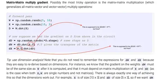

EDIT: Id like to add the context of this question. It's coming from here, and here is my marked screen-shot of my problem. How are they deriving those terms? (Note: I understand the chain-rule aspect, and I am not wondering about that. I am asking about the simpler intermediate step).

Upon reading the article you added (and after some sleep!), I've noticed that $dD$ is not $\partial D$ in their notation, but rather $\dfrac {\partial f}{\partial D}$ where $f$ is a certain function of $W$ and $X$ while $D=WX$. This means that the first expression you're having problems with is $$\frac{\partial f}{\partial W}=\frac{\partial f}{\partial D}X^T$$ Since the author at the beginning stated that he'd use the incorrect expression "gradient on" something to mean "partial derivative" with respect to that same thing. So any element of $\partial f/\partial W$ can be written as $\partial f/\partial W_{ij}$. And any element of $D$: $$D_{ij}=\sum_{k=1}^qW_{ik}X_{kj}$$
We can write $$df=\sum_i\sum_j \frac{\partial f}{\partial D_{ij}}dD_{ij}$$ $$\frac{\partial f}{\partial W_{dc}}=\sum_{i,j} \frac{\partial f}{\partial D_{ij}}\frac{\partial D_{ij}}{\partial W_{dc}}=\sum_j \frac{\partial f}{\partial D_{dj}}\frac{\partial D_{dj}}{\partial W_{dc}}$$ This last equality is true since all terms with $i\neq d$ drop off. Due to the product $D=WX$, we have $$\frac{\partial D_{dj}}{\partial W_{dc}}=X_{cj}$$ and so $$\frac{\partial f}{\partial W_{dc}}=\sum_j \frac{\partial f}{\partial D_{dj}}X_{cj}$$ $$\frac{\partial f}{\partial W_{dc}}=\sum_j \frac{\partial f}{\partial D_{dj}}X_{jc}^T$$
This means that the matrix $\partial f/\partial W$ is the product of $\partial f/\partial D$ and $X^T$. I believe this is what you're trying to grasp, and what's asked of you in the last paragraph of the screenshot. Also, as the next paragraph after the screenshot hints, you could've started out with small matrices to work this out before noticing the pattern, and generalizing as I attempted to do directly in the above proof. The same reasoning proves the second expression as well...

  • Thank you GeorgSaliba - but I am still not getting it... The thing I am stuck on is: why is $\frac{\delta D_{dj}}{\delta W_{dc}} = X_{cj}$? ... This is what I am stuck on... thanks. – Spacey Jul 22 '16 at 16:12
  • @Spacey in order for an element from $D$ to contain the variable $W_{dc}$ is for it to have the same row index $d$ otherwise, deriving will lead to a zero. Then, if you look at the product of the two matrices, you notice that there are many terms $W$ with row index $d$ but only one has column index $c$, so all terms vanish except $W_{dc}X_{cj}$ which when derived with respect to $W_{dc}$ gives $ X_{cj}$. – entrelac Jul 22 '16 at 16:21

Like most articles on Machine Learning / Neural Networks, the linked document is an awful mixture of code snippets and poor mathematical notation.
If you read the comments preceding the code snippet, you'll discover that dX does not refer to an increment or differential of $X,$ or to the matrix-by-matrix derivative $\frac{\partial W}{\partial X}.\;$ Instead it is supposed to represent $\frac{\partial \phi}{\partial X}$, i.e. the gradient of an unspecified objective function $\Big({\rm i.e.}\;\phi(D)\Big)$ with respect to one of the factors of the matrix argument: $\;D=WX$.
Likewise, dD does not refer to an increment (or differential) of D but to the gradient $\frac{\partial \phi}{\partial D}$
Here is a short derivation of the mathematical content of the code snippet. $$\eqalign{ D &= WX \\ dD &= dW\,X + W\,dX \quad&\big({\rm differential\,of\,}D\big) \\ \frac{\partial\phi}{\partial D} &= G \quad&\big({\rm gradient\,wrt\,}D\big) \\ d\phi &= G:dD \quad&\big({\rm differential\,of\,}\phi\big) \\ &= G:dW\,X \;+ G:W\,dX \\ &= GX^T\!:dW + W^TG:dX \\ \frac{\partial\phi}{\partial W} &= GX^T \quad&\big({\rm gradient\,wrt\,}W\big) \\ \frac{\partial\phi}{\partial X} &= W^TG \quad&\big({\rm gradient\,wrt\,}X\big) \\ }$$ Unfortunately, the author decided to use the following variable names in the code:
  • dD   for $\;\frac{\partial\phi}{\partial D}$
  • dX   for $\;\frac{\partial\phi}{\partial X}$
  • dW   for $\;\frac{\partial\phi}{\partial W}$
With this in mind, it is possible to make sense of the code snippet $$\eqalign{ {\bf dW} &= {\bf dD}\cdot{\bf X}^T \\ {\bf dX} &= {\bf W}^T\cdot{\bf dD} \\ }$$ but the notation is extremely confusing for anyone who is mathematically inclined.

Just to add to GeorgSaliba's excellent answer, you can see this must be the case intuitively.
Given a function $f(D)$ with $D=WX$, if all variables were scalars, we clearly have $$\frac{\partial f}{\partial W}=\frac{\partial f}{\partial D}\frac{\partial D}{\partial W}=\frac{\partial f}{\partial D}X$$ Now in the non-scalar case we expect the same exact form, up to some change of multiplication order, transpose, etc., due the non-scalar nature, but the overall form has to reduce to the same form in the scalar case, so it can't really be substantially different from the above.
Now, ${\partial f}/{\partial \bf D}$ in the non-scalar case has the same dimensions of $\bf D$, say a $n \times p$ matrix, but $\bf X$ is an $m × p$ matrix, which means we can't really do the multiplication as it stands. What we can do, is transpose $\bf X$, allowing us to do the multiplication, and giving the correct result of $n \times m$ for ${\partial f}/{\partial \bf W}$ which of course must have the same dimensions as $\bf W$. Thus, we see that we must have: $$\frac{\partial f}{\partial \bf W}=\frac{\partial f}{\partial \bf D}{\bf X}^T$$ One can formalize this into an actual proof, but we'll let this stand as only an intuitive guide for now.
