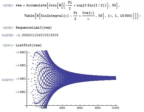

First, let's establish the numerical value of the sum. Since $$\operatorname{Si}(n) - \frac{\pi}{2} = -\frac{\cos(n)}{n} \left(1 + \mathfrak{o}(n^{-2})\right) - \frac{\sin(n)}{n^2} \left(1 + \mathfrak{o}(n^{-2})\right)$$ we shall evaluate: $$ \sum_{n=0}^\infty \left(\operatorname{Si}(n) - \frac{\pi}{2}\right) = -\frac{\pi}{2} + \sum_{n=0}^\infty \left(\operatorname{Si}(n) - \frac{\pi}{2} + \frac{\cos(n)}{n}\right) - \sum_{n=1}^\infty \frac{\cos(n)}{n} \tag{1} $$ The middle sum now converges unconditionally. The conditionally convergent sum is easy to evaluate in closed form: $$ -\sum_{n=1}^\infty \frac{\cos(n)}{n} = -\Re \left(\sum_{n=1}^\infty \frac{\mathrm{e}^{i n}}{n} \right) = \Re\left( \log\left(1-\mathrm{e}^i \right) \right) = \log\left(2 \sin \left(\frac{1}{2}\right)\right) $$ The following image displays the partial sums of $(1)$: enter image description here
Thus the numerical value of the sum is approximately $-1.869201$.

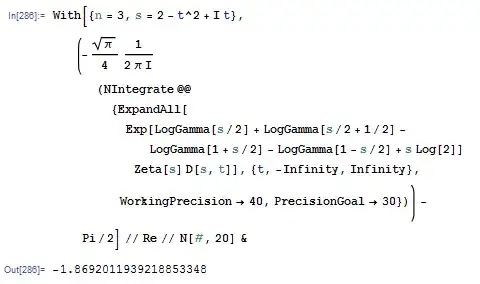

Thus: $$ \sum_{n=0}^\infty \left( \operatorname{Si}(n) - \frac{\pi}{2}\right) = -\frac{\pi}{2} - \frac{\sqrt{\pi}}{2} \cdot \frac{1}{2 \pi i} \int_{\mathcal{L}} \,\, \frac{\Gamma(s) \Gamma\left(s+\frac{1}{2}\right)}{\Gamma(1+s)\Gamma(1-s)} 4^s \zeta(2s) \mathrm{d} s $$ Here is a numerical confirmation: enter image description here
