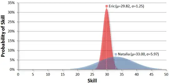

Do as Microsoft's TrueSkill does. When you estimate a player's skill, quantify too the uncertainty $\sigma$ of your estimate $\mu$. This uncertainty should decrease as players accrue more results. Then, rank players by a conservative lower bound $\mu - 2\sigma$. Thus, for the situation below you would rank Experienced Eric over N00b Natalia. Natalia can prove how good she is by playing more games, and Eric can never complain her rank is due to beginner's luck.
Experienced Eric and n00b Natalia
Another boon: you can scratch your threshold and rank players as soon as they have played one game.
Image taken from the fine introduction to TrueSkill at http://www.moserware.com/2010/03/computing-your-skill.html
