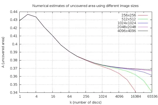

Here is some C code using OpenGL to estimate numerically. And a plot of the results (I plotted different image sizes to get a sense of how well it approximates the true value). The limit seems to agree with Ross's analytic answer.
numerical estimates

  • It should be true that the uncovered area approaches $\frac 1e$ from above. The area that has greater probability to not be covered is a strip of width $\frac 2k$ around the edge of the square. This strip gets smaller as $k$ gets larger. – Ross Millikan Jun 20 '16 at 03:04
  • @Ross: I think you're right, but you'd also need to argue that this error dominates the one from replacing $\left(1-\frac1k\right)^k$ by $\mathrm e^{-1}$, which has the other sign. – joriki Jun 20 '16 at 10:50
