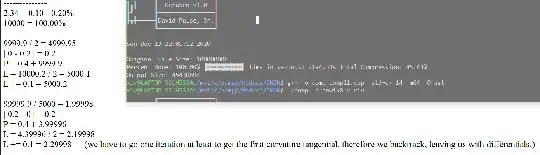

I had to do a crash course in Calculus. I was doing some stuff and honestly, it was the trig that was messing me up the whole time. I don't know $e$ and I don't pretend to. But what I did instead was sort of miraculous. $$y = | \text{baseline} - \text{Y-axis} |$$ $$t = \text{length of a to b} $$ $$x=2$$ $$m = \frac{sec(x)}{2}$$ $$n = | y - t |$$ $$P = (m*2) + (n*2)$$ $$L_n = \frac{P}{2} + \frac{n}{2}$$
If you add the $L_n$ answers together, you get an integrand of the entire curve.
If you average them using the $V = L_0 + L_1 + L_2 + ...$ and dividing by the largest integer, $G = n-1$ then you'll have the integral of the equation: $VG$
Finally, if you the differential of a Gaussian equation, you do the first algorithm I made, and replace $x$ with the answer to it. The derivative will be divided into the first answer. This is the differential. And obviously you can keep going in derivatives.
Here is the proof of it working
