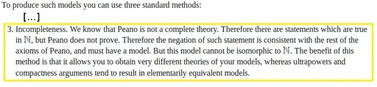

  3. Incompleteness. We know that Peano is not a complete theory. Therefore there are statements which are true in $\Bbb N$, but Peano does not prove. Therefore the negation of such statement is consistent with the rest of the axioms of Peano, and must have a model. But this model cannot be isomorphic to $\Bbb N$. The benefit of this method is that it allows you to obtain very different theories of your models, whereas ultrapowers and compactness arguments tend to result in elementarily equivalent models.

  • Mathematical footnote: the 'standard method 3' shows even a little more: not only that Peano admits nonstandard models, but by the incompleteness theorem it follows that that there cannot even be any set of axioms which would determine $\mathbb{N}$ uniquely up to isomorphism. Historical footnote: this (consequence of) 'standard method 3' is known since at least Gödel's review in Zentralblatt (Band 7, Heft 5) of Skolem's 1933 paper, see footnote in answer-form further below in this thread. – Peter Heinig Jan 29 '18 at 19:52

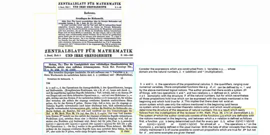

This is a historical footnote to the nice accepted answer above. More precisely, the method in the yellow box in
seems to be already hinted at in Kurt Gödel's review in Zentralblatt, Band 7, Heft 5, of
Über die Unmöglichkeit einer vollständigen Charakterisierung der Zahlenreihe mittels eines endlichen Axiomensystems. Norsk Mat. Forenings Skr., II. Ser. No.1/12, 73-82 (1933).
Strictly speaking, Gödel does not give an argument in the review, only says that Skolem's result follows easily from his own article on the incompleteness theorem; here is Gödel's review of Skolem's paper, with Gödel's hint highlighted in orange (the right-hand side is my translation):
