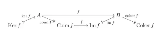

A morphism $f: A \to B$ in an abelian category has four associated objects and five associated morphisms:
Analysis of a morphism
The kernel $\text{ker}\,(f): \text{Ker}\,(f) \to A$, the cokernel $\text{coker}\,(f): B \to \text{Coker}\,(f)$, the coimage $\text{Coim}\,{(f)} = \text{Coker}\,(\text{ker}\,(f))$ and the image $\text{Im}\,(f) = \text{Ker}\,(\text{coker}\,(f))$. The main axiom of abelian categories states that the canonical morphism $\hat{f}:\text{Coim}\,(f) \to \text{Im}\,(f)$ (uniquely determined by requiring that the diagram be commutative) always is an isomorphism.

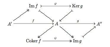

Now given two morphisms $f:A' \to A$ and $g:A \to A''$ such that $gf = 0$ there are three ways to define the homology of the "complex" $A' \to A \to A''$:
  1. $\text{Coker}\,(\text{Im}\,(f) \to \text{Ker}\,(g))$,
  2. $\text{Ker}\,(\text{Coker}\,(f) \to \text{Coim}\,(g))$,
  3. $\text{Im}\,(\text{Ker}\,(g)\to \text{Coker}\,(f))$.
Homology decomposition
The first of these corresponds to the usual $\text{Ker}/\text{Im}$ and it is not very hard to show that all three ways give canonically isomorphic objects in an abelian category. It is essential to require the category to be abelian here, the three possibilities are distinct in a general additive category (with kernels and cokernels).

    Let me just add that the possibilities 1. and 2. are dual to each other while possibility 3. is self-dual because $\text{Coim} = \text{Im}$ in an abelian category. – t.b. Jan 19 '11 at 12:15
    I am curious about how you get the diagrams to show up. Did you write it in tex somewhere else compile it, and post it as a picture? – Sean Tilson Jan 19 '11 at 21:48
    In case anyone is curious for a reference, this stuff is explained on page 178 of Categories and Sheaves, including the second diagram, and several more isomorphic objects which deserve to be called the homology. – ಠ_ಠ Jun 24 '17 at 12:30
    Can someone explain why 1-3 in the answer are the same? – zxcv Aug 21 '21 at 13:29
    I posted a new question about my above comment: https://math.stackexchange.com/questions/4230156/in-abelian-category-how-can-one-prove-that-the-three-definitions-of-homology-ar – zxcv Aug 22 '21 at 06:37
