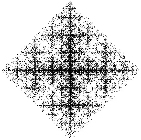

I was curious whether this fractal(?) is named/famous, or is it just another fractal?
I was playing with the idea of randomness with constraints and the fractal was generated as follows:
  1. Draw a point at the center of a square.
  2. Randomly choose any two corners of the square and calculate their center.
  3. Calculate the center of the last drawn point and this center point of the corners.
  4. Draw a new point at this location.
Not sure if this will help because I just made these rules up while in the shower, but sorry I do not have any more information or an equation.
Thank you.

    Where did it come from? Do you have any other information? Maybe an equation? – jdods May 22 '16 at 12:39
  • How does one generate this fractal? Also I suppose the fractal isn't what the picture itself represents, but rather some "limit object" we approach when we keep on generating. – Wojowu May 22 '16 at 12:42
    At first I thought that this is similar to the cayley graph of the free group in two generators, but there's a difference. Considering how easy it is to describe this fractal, I agree there should be a name, but I am not familiar with fractals. – blue May 22 '16 at 12:44
  • Apologies. I have updated the post with information on how it was generated. – Silver May 22 '16 at 12:44
  • @blue Yes I was thinking exactly the same thing – user140776 May 22 '16 at 12:47
  • where did you get the picture from? How was it generated? Without this information its impossible to say, although to me it looks like it was generated by some version of the "chaos game" – user140776 May 22 '16 at 12:42
  • Yes, 'chaos game', I believe, is the technical term. It just looked familiar so I asked, but maybe that's because many fractals look familiar? – Silver May 22 '16 at 12:45
  • Here's a deterministic way to arrive at something similar (I hope the details work out). Draw a point in the center of the square. Call the set that contains only this point $S_1$. For all points in $S_n$ draw four points, shifted by $2^{-n}$ in all four axis directions from the chosen point; the set of all these is $S_{n+1}$. – blue May 22 '16 at 12:55
  • Step 2 : What does "the center of two corners" mean? – DanielWainfleet May 22 '16 at 13:09
  • The center of the line joining the two corners (which were randomly chosen). – Silver May 22 '16 at 13:11
  • @blue: I think your proposal generates the same points though probably it won't have the same density (when you take the union). – user21820 May 22 '16 at 15:09
  • It sort of looks like a Vicsek snowflake – slebetman May 22 '16 at 16:11
  • Can the two corners from step 2 be identical? – filipos May 22 '16 at 16:36
  • It looks like the area inside a Cesàro fractal. https://i.sstatic.net/I5JV8.png – f'' May 22 '16 at 17:59
  • https://en.wikipedia.org/wiki/Barnsley_fern also generated via also generated via randomness – djechlin May 23 '16 at 00:41
    I just made these rules up while in the shower That gets my upvote :) – Caleb Stanford May 23 '16 at 21:15
  • This looks like the cayley graph of a free group. – Ali Caglayan Jun 17 '16 at 21:51

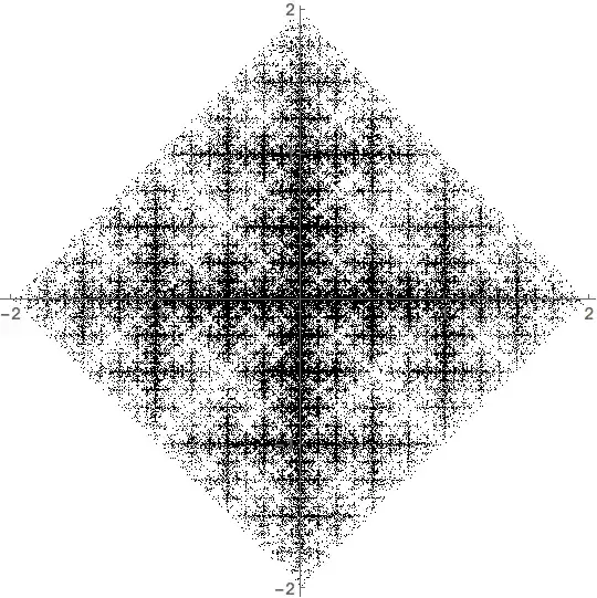

Your image can be generated using a weighted iterated function system or IFS. Specifically, let \begin{align} f_0(x,y) &= (x/2,y/2), \\ f_1(x,y) &= (x/2+1,y/2), \\ f_2(x,y) &= (x/2,y/2+1), \\ f_3(x,y) &= (x/2-1,y/2), \text{ and } \\ f_4(x,y) &= (x/2,y/2-1). \end{align} Let $(x_0,y_0)$ be the origin and define $(x_n,y_n)$ by a random, recursive procedure: $$(x_n,y_n) = f_i(x_{n-1},y_{n-1}),$$ where $i$ is chosen randomly from $(0,1,2,3,4)$ with probabilities $p_0=1/3$ and $p_i=1/6$ for $i=1,2,3,4$.
If we iterate the procedure $100,000$ times, we generate the following image: enter image description here
This image is a solid square but the points are not uniformly distributed throughout that square. Technically, this illustrates a self-similar measure on the square.
To be a bit more clear, an invariant set of an IFS is a compact set $E\subset\mathbb R^2$ such that $$E = \bigcup_{i=0}^4 f_i(E).$$ It's pretty easy to see that the square with vertices at the points $(-2,0)$, $(0,-2)$, $(2,0)$, and $(0,2)$ is an invariant set for this IFS. It can be shown that an IFS of contractions always has a unique invariant set; thus, this square is the only invariant set for this IFS.

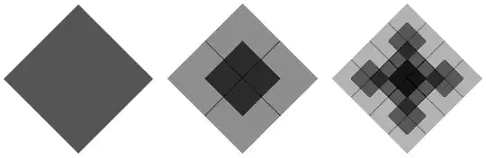

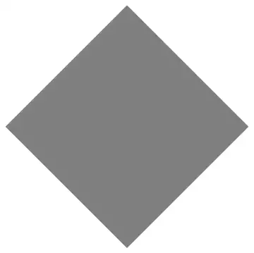

Let's call this square $E$, in honor of its status as an invariant set. We can get a deterministic understanding of the distribution of points on $E$ by thinking in terms of a mass distribution on the square (technically, a measure). Start with a uniform mass distribution throughout the square. Generate a second mass distribution on $E$ by distributing $1/3$ of the mass to $f_0(E)$ and $1/6$ of the mass to each of $f_i(E)$ for $i=1,2,3,4$. We can then iterate this procedure. The step from the original distribution to the next to the next might look like so:
The evolution of the first 8 steps looks like
