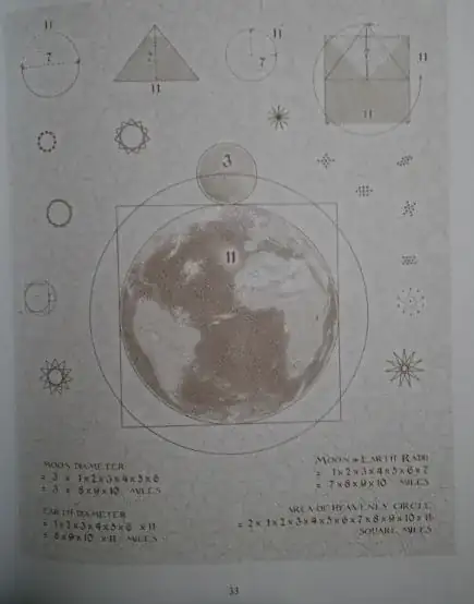

In the book The Quadrivium, page 32 it says
Shown opposite is the extraordinary fact that the size of the Moon relates to the size of the Earth as does three to eleven. What this means is that if we draw down the Moon to the Earth, as shown, then a heavenly curcle through the Moon will have a circumference equal to the perimeter of a square around the Earth. This is called 'squaring of the circle.'

    Historically, Squaring the Circle refers to area, not perimeter. But mathematically both problems come down to constructing a segment of length $\pi$ using straightedge and compass, so in that sense they are equivalent. – lulu May 14 '16 at 14:08
    Note: the first reference is just an approximation (and not a very good one). If you suppose that the radius of the earth is $1$ (in some units) then we'd get that the perimeter of the square is $8$ and the circumference of the circle is $2\pi\frac {14}{11}\sim 7.9967813$. So...it's close, but certainly not equal. – lulu May 14 '16 at 14:12
