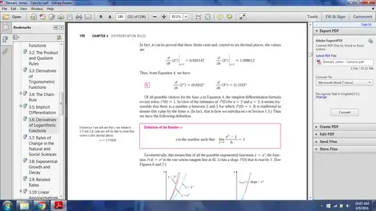

This sprung from a conversation here. In Stewart's Calculus textbook, he defined $e$ as the unique solution to $\lim\limits_{h\to 0}\frac{x^h-1}{h}=1$. Ahmed asked how do you define $x^h$ is not by $\exp(h\ln(x))$ and I'm not sure.
Does this definition of $e$ even make sense?
