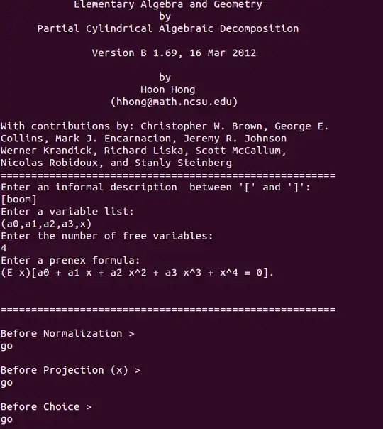

I wanted to find the semialgebraic set in the $(a_0,a_1,a_2,a_3)$ space that guarantees that there exists at least one real root of the general polynomial equation of degree 4. For that purpose, installing QEPCAD on Ubuntu 14, I tried to eliminate the only existential quantifier in
$\exists x[x^4 + a_3 x^3 + a_2 x^2 + a_1 x + a_0 = 0]$
Giving successive input as
made QEPCAD think for several minutes, and then fail, due to lack of memory I suppose (actually a similar problem is among the examples on QEPCAD site, http://www.usna.edu/CS/qepcadweb/B/examples/Quartic/Quartic.html, but even increasing, for that problem, the +N from the default value to +N80000000, did not help).

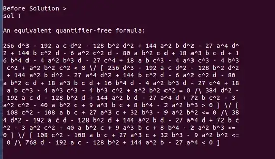

EDIT: there was maybe some environment issue, or an issue with the precise syntax I used, though I did not get any error message regarding syntax, or another mistake I made (I will try to understand what happened, and then edit the question again). Right now I got, after very little time, eliminating quantifiers from
$\exists x[x^4 + a x^3 + b x^2 + c x + d = 0]$

well, things are more complicated.. First, the program QEPCAD is interactive, and the user apparently can specify different options on the command line at various stages of searching for a solution. I could not find the documentation of these options on QEPCAD site (perhaps I did not search well enough). Second, the ability of QEPCAD to eliminate quantifiers in the formula I specified depends on variable names (which means probably that it depends on variables order, http://staff.bath.ac.uk/masjhd/ISSACs/ISSAC07-final.pdf ), so while $\exists x[x^4 + a x^3 + b x^2 + c x + d = 0]$ was solved in 1 second or so, but $\exists x[x^4 + d x^3 + c x^2 + b x + a = 0]$ was not (I am still waiting for the solution to come out, that is, afer having inserted "go" on the command line whenever interactive input was expected).

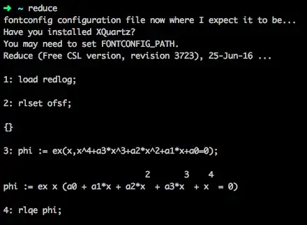

The Reduce package, Redlog, works with your example; it gives an answer in a few seconds (see the next picture for the input in Reduce; I don't include the output because it is too large). Here you have the Redlog manual.
In this paper you can find some comments on QEPCAD and a few other implementations of quantifier elimination.
You can also check this Maple subpackage

  • Yes, Redlog seems to work perhaps a bit better than QEPQAD (I tried to change the names of the coefficients, and it still worked). But at least with the default settings (I did not try to check how to change memory settings), it closes with an error (Windows 7, 8Gb) on the corresponding problem for the general sixth degree equation - even if I eliminate one of the coefficients. So the error comes out when only one existential quantifier is involved and the dimension (coeffs + the variable x) is just 6.. I still did not try Maple, though. –  Sep 23 '16 at 17:40
    My computer does not compute the 6 degree polynomial with 5 parameters either. Let me try it on Monday on Maple. As an additional comment, here you can find a possible use to Biology of the CADs (see section 4): http://arxiv.org/pdf/1502.03188v1.pdf Basically, they want to know for which set of parameters there is more than one real solution to some polynomial system. – A2012N Sep 23 '16 at 20:22
