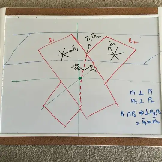

@MvG has answered it and I accepted it. I just wanted to post a picture I've drawn for this to help me understand in case if someone else finds it useful.
Interpretation of line intersection in homogeneous space
