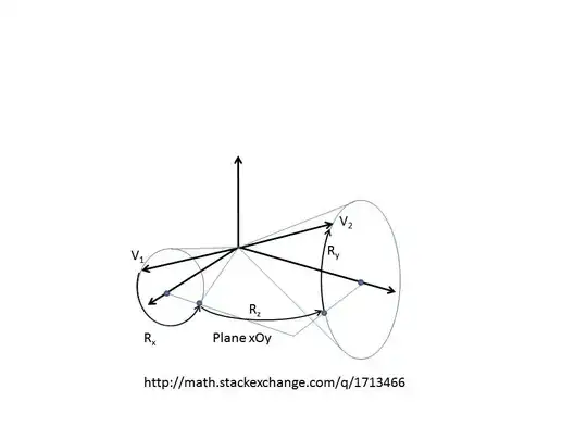

We refer to the figure below.
Let $V_1$ and $V_2 $ be the normalized vectors $A$ and $B$ (unit associated vectors). It suffices to know how to transform $V_1$ into $V_2$, with resizing at the begining and at the end. So we are going to work on the unit sphere.
A solution to your problem is by the following succession of rotations $R_x$ followed by $R_z$ followed by $R_y$:
  • $R_x$ brings $V_1$ onto a vector $R_x(V_1)$ of the equatorial (xOy) plane.
  • $(R_y)^{-1}$ (take care of the $-1$) brings $V_2$ onto another vector $(R_y)^{-1}(V_2)$ of the equatorial (xOy) plane.
  • $R_z$ brings $R_x(V_1)$ onto $(R_y)^{-1}(V_2)$.
The consequence is that $R_z(R_x(V_1))=(R_y)^{-1}V_2$, meaning that
$$R_y(R_z(R_x(V_1)))=V_2$$
as desired.
I do not enter into computational details: the angles of rotations $R_x,R_y,R_z$ are easily obtained. But we can have a discussion about it.
