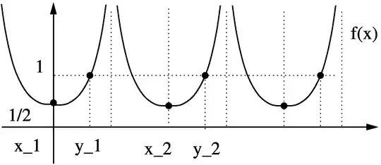

In this question the asker mentions that the limit of this does not exist: $$\lim_{x\to \infty} \frac{1}{1+\cos(x)}$$ Graphically I can see that the limit doesn't exist, but I'd like to know what the proof is. I'm also wondering if there is a general rule that can be applied to any limit to tell if the limit exists.
Sorry if this question is a bit dumb, and thanks in advance for any answers.

Let $f$ be a function defined on $\mathbb{R}$ and $\ell\in \mathbb{R}$. Then $\displaystyle \lim_{x \rightarrow +\infty}f(x)=\ell$ if and only if for every sequence $(x_n)$ that tends to $+\infty$, we get $f(x_n) \rightarrow \ell$.
So, in order to prove that a limit $\displaystyle \lim_{x \rightarrow +\infty}f(x)$ does not exist, it is enough to prove that there are sequences $(x_n),~(y_n)$ that tend to $+\infty$ and $\ell_1,~\ell_2\in \mathbb{R}$, such that $\displaystyle \lim_{n \rightarrow +\infty}f(x_n)=\ell_1\neq \ell_2=\displaystyle \lim_{n \rightarrow +\infty}f(y_n).$
In our case: take $x_n=2\pi n,~y_n=2\pi n+\pi/2.$

Suppose $\lim\limits_{x\to\infty} \dfrac 1 {1+\cos x} = L$.
Then for some number $x_0$, whenever $x>x_0$ then $ \dfrac 1 {1+\cos x}$ is between $L\pm 0.0001$.
There are some values of $x>x_0$ for which $\dfrac 1 {1+\cos x} = \dfrac 1 {1+0} = 1$ and there are some values of $x>x_0$ for which $\dfrac 1 {1+\cos x} = \dfrac 1 {1+1} = \dfrac 1 2$.
Therefore the numbers $1$ and $1/2$ are both between $L\pm0.0001$. That implies $1$ differs from $1/2$ by less than $2\times0.0001$.
