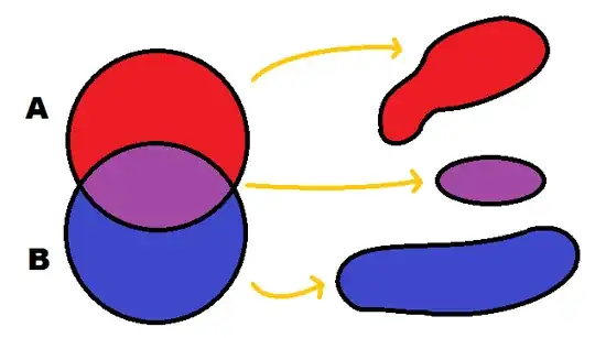

I find a Venn diagram helpful.
venn
The set $f(A\cap B)$ is the purple on the RHS, whereas $f(A)$ is the union of purple and red and $f(B)$ is the union of purple and blue on the right. In order for $f(A\cap B)=f(A)\cap f(B)$, the red and blue regions in the codomain (the right) must be disjoint. However, it should be clear that, at least with sets, this is not generally the case, because all three regions on the right can be controlled for independently by controlling the function $f$ as one wishes. (This aid also helps with OJ's exercise.)
