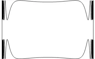

First example. Let's examine the analogous problem for path-connectedness. The following example shows that the boundary might not be path-connected even if $A$ and $X\setminus A$ are (here $X = \Bbb R^n$): let $$A=\{(x,y)\in\Bbb R^2|\;y^2< 2+\sin\frac1{1-x^2}, x^2<1\}.$$ The boundary of this set is a bit similar to the topologist's sine curve and looks as follows:
As we can see, both $A$ and $X\setminus A$ are path-connected, but $\partial A$ isn't (by the same argument as for the topologist's sine curve).
