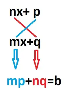

But of course, I imagine your aim is to factor it when all of the coefficients are integers. In that scenario, there is a much simpler method.
$$ax^2+bx+c=(nx+p)(mx+q)$$
And you also have $nm=a$, $pq=c$, and $nq+mp=b$.
Just remember that the first constants on the right multiplied equals the first coefficient on the left. The last constants on the right multiplied equals the last constant on the left.
And the 'cross' multiplication equals the middle coefficient.
