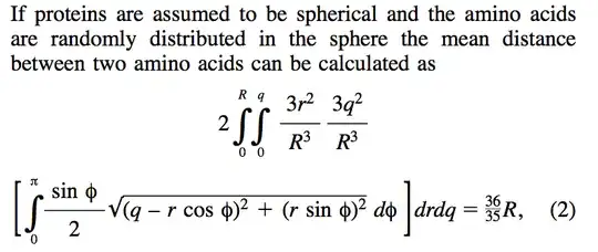

We ran into it some years back when doing research on proteins (http://www.ncbi.nlm.nih.gov/pubmed/9514112).
