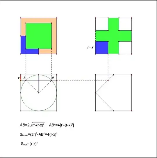

In addition to the methods of calculus, Pappus, and Archimedes already mentioned, Cavalieri's Principle can be useful for these kinds of problems.
Suppose you have two solid figures lined up next to each other, each fitting between the same two parallel planes. (E.g., two stacks of pennies lying on the table, of the same height). Then, consider cutting the two solids by a plane parallel to the given two and in between them. If the cross-sectional area thus formed is the same for each of the solids for any such plane, the volumes of the solids are the same.
If you're willing to accept that you know the volume of a cone is 1/3 that of the cylinder with the same base and height, you can use Cavalieri, comparing a hemisphere to a cylinder with an inscribed cone, to get the volume of the sphere. This diagram (from Wikipedia) illustrates the construction: look here
Consider a cylinder of radius $R$ and height $R$, with, inside it, an inverted cone, with base of radius $R$ coinciding with the top of the cylinder, and again height $R$. Put next to it a hemisphere of radius $R$. Now consider the cross section of each at height $y$ above the base. For the cylinder/cone system, the area of the cross-section is $\pi (R^2-y^2)$. It's the same for the hemisphere cross-section, as you can see by doing the Pythagorean theorem with any vector from the sphere center to a point on the sphere at height y to get the radius of the cross section (which is circular).
Since the cylinder/cone and hemisphere have the same height, by Cavalieri's Principle the volumes of the two are equal. The cylinder volume is $\pi R^3$, the cone is a third that, so the hemisphere volume is $\frac{2}{3} \pi R^3$. Thus the sphere of radius $R$ has volume $\frac{4}{3} \pi R^3$.

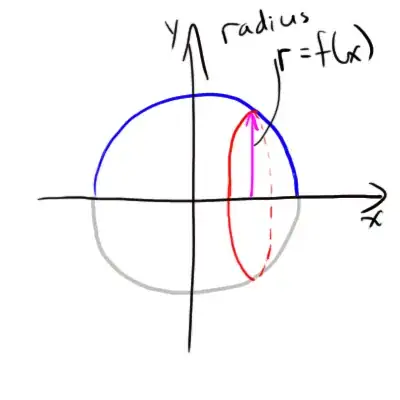

A complete answer using the disk method would be the following.
If you revolve $y=\sqrt{r^2-x^2}$ about the $x$-axis (and form a solid) you get the volume of a sphere.
Form a disk with height $f(x)$, and find its area.
The area of the red disk above is $\pi r^2$, or $\pi f(x)^2$, or we could say $\pi \sqrt{r^2-x^2}^2=\pi \left (r^2-x^2\right )$ at any point $x$ between $x=-r$ and $x=r$.
To find the volume of a sphere of radius $r$ then, just add up the areas of infinitesimally thin disks on as $x$ goes from $-r$ to $r$.
To work it out:\begin{align*}\int \limits _{-r}^r\pi \sqrt{r^2-x^2}^2\,dx & =2\pi \int \limits _0^rr^2-x^2\,dx \\ & =2\pi \left (\left .r^2x-\frac{1}{3}x^3\right )\right |_0^r \\ & =2\pi \left (r^3-\frac{1}{3}r^3\right ) \\ & =\frac{4\pi}{3}r^3. \end{align*}

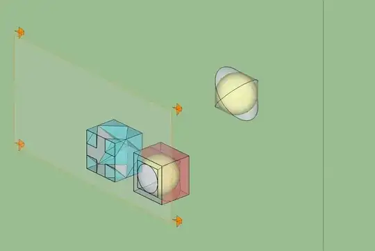

I'll add a Chinese version for fun.
The ancient Chinese had another way to calculate this volume.
The principle is same as Cavalieri's Principle; the difference is using the intersection of two perpendicular cylinders, a "bicylinder", to pack the sphere. The Chinese name for this shape is 牟合方蓋 or "mouhefanggai" (meaning two square umbrellas).
Every plane (parallel to the cylinders' axes) intersects in a square with the bicylinder and intersects in a circle with the sphere (for more pictures and an animation, see http://phdfishman.blogspot.com/2010/02/blog-post_07.html ). This means that the volume ratio of the sphere to the bicylinder is proportional to the areas of the circles and squares: $\dfrac{\pi r^2}{(2r)^2}=\dfrac{\pi}{4}$.
Now the question becomes calculating the volume of the bicylinder (white). It is also very difficult, so add a cube (red) packing the bicylinder (white). Now when the plane intersects the cube, it forms another larger square. The extra area in the large square (the big square from the cube minus the smaller square from the bicylinder), is the same as $4$ small squares (blue). As the plane cutting through the solids moves, these blue squares will form $4$ small pyramids in the corners of the cube with isosceles triangle sides and their apex at the edge of the cube. Moving through the whole bicylinder generates a total of $8$ pyramids.
Now we can calculate the volume of the cube (red) minus the volume of the eight pyramids (blue) to get the volume of the bicylinder (white). The volume of the pyramids is:$$8\cdot \frac{1}{3}r^2\cdot r=\frac{8}{3}r^3,$$and then we can calculate that the bicylinder volume is $(2r)^3-\dfrac{8}{3}r^3=\dfrac{16}{3}r^3$.
Finally, using the ratio of the volumes of the bicylinder and the sphere from above, the sphere's volume is $\dfrac{\pi}{4}\dfrac{16}{3}r^3=\dfrac{4\pi}{3}r^3$.
Now you can see that $3$ is from the pyramids and $4$ is from the cube! They are not random.
This picture shows the geometric relationships.

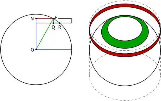

In the diagram below on the left, we will assume that the the size of $\triangle PQR$ is infinitesimal compared to $\triangle PNO$, and thus, the green arc and the segment $\overline{PR}$ are essentially equal in length. Note that both $\angle NPO$ and $\angle QPR$ are complementary to $\angle OPQ$, and therefore, equal. Thus, the right triangles $\triangle PNO$ and $\triangle PQR$ are similar (corresponding sides are colored similarly). Since $\triangle PNO$ and $\triangle PQR$ are similar, $$ \overline{NP}\cdot\overline{PR}=\overline{OP}\cdot\overline{PQ}\tag{1} $$ The inner circumference of the green annulus on the sphere to the right is $2\pi\overline{NP}$ and its outer circumference is $2\pi\left(\overline{NP}+\overline{QR}\right)$, while its width is $\overline{PR}$. Therefore, its area is between $2\pi\overline{NP}\cdot\overline{PR}$ and $2\pi\left(\overline{NP}+\overline{QR}\right)\cdot\overline{PR}$.
The circumference of the red strip on the cylinder to the right is $2\pi\overline{OP}$, while its width is $\overline{PQ}$. Therefore, its area is $2\pi\overline{OP}\cdot\overline{PQ}$.
According to $(1)$, the difference between the area of the green annulus on the sphere and the red strip on the cylinder is less than $2\pi\overline{QR}\cdot\overline{PR}$. Summing $\overline{QR}$ as we walk down the sphere gives $2\overline{OP}$ (one as $\overline{NP}$ increases and one as it decreases), thus, the difference between the area of the sphere and the area of the cylinder is less than $4\pi\overline{OP}\cdot\max\overline{PR}$, which can be made to vanish by making $\overline{PR}$ as small as we wish.
Thus, the area of the sphere is equal to the area of the cylinder. Since the circumference of the cylinder is $2\pi r$ and its height is $2r$, we get that the area of the cylinder, and therefore the sphere, is $4\pi r^2$.
$\hspace{4mm}$
To compute the volume of the sphere, we just sum the surface area of all spherical shells times their thickness: $$ V=\int_0^r4\pi t^2\,\mathrm{d}t = \frac43\pi r^3\tag{2} $$

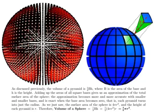

To expand on what anosov_diffeomorphism said:
Suppose we agree that the surface area of a sphere is 4 π r2 (If we do not agree on this, that would be a great question to ask on this site, and then someone can edit this answer to link to it!). Now if I have a sphere of radius r, and I increase the radius by a tiny amount, dr, then the new, expanded sphere has a volume that is bigger, by the volume of the thin spherical shell that was just added. If dr is small enough, then it doesn't much matter whether we look at the inner or outer radius of that shell, and we can just say that the shell's volume is approximately 4 π r2 dr. So the difference in volume between two spheres of radius $r_1$ and $r_2$ is $\int_{r_1}^{r_2}$ 4 π r2 dr, which is 4/3 π r^3
- 3,147

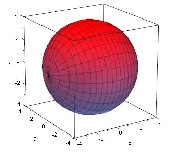

To add to the approach of @bobobobo, it can be shown that we can construct the volume $V_n$ of an $n$ dimensional sphere from the volume $V_{n-1}$ of an $n-1$ dimensional sphere using the following recurrence relation:
$$V_n = 2r V_{n-1} \int_0^{\frac{\pi}{2}}\cos^n\theta d\theta$$
using this relation starting with $V_0 =1$ we get:
$$V_1 = 2r V_0 = 2r$$
$$V_2 = \frac{\pi}{2}r V_1 = \pi r^2$$
$$V_3 = \frac{4}{3}r V_2 = \frac{4}{3}\pi r^3$$
continuing...
$$V_4 = \frac{3\pi}{8}r V_3 = \frac{1}{2}\pi^2 r^4$$

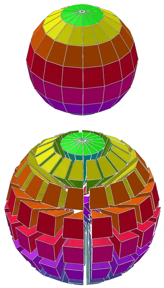

If we already knew that the surface of the sphere is $4\pi r^2$, then we could go like this:
We could divide the surface into small polygons (you can imagine them infinitesimally small). The area of these polygons approximate the area of the surface. Now the volume of the sphere would be approximated by the pyramids obtained from the polygons, each of them having volume $(1/3)*\text{base}*\text{height}$.
Since height is approximately $r$ (as we make the polygons smaller) and the bases together give the area of $4\pi r^2$, we arrive to $V=\frac43 \pi r^3$.
(Although I have to admit that I liked this better as a way of deriving the formula for the surface area from the volume.)

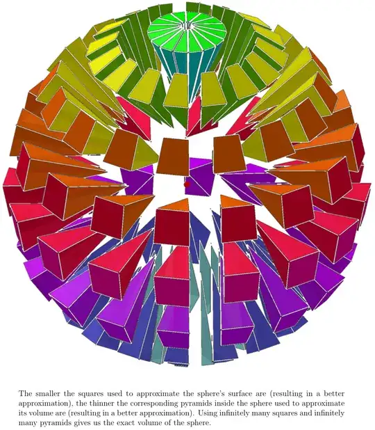

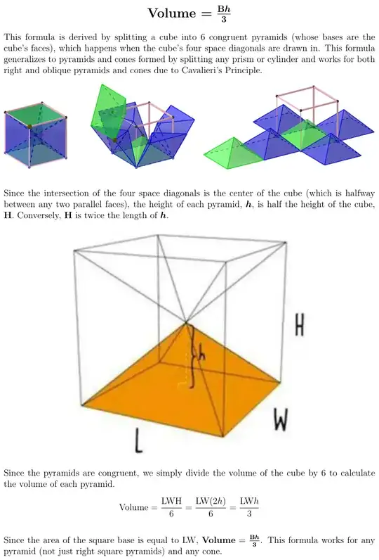

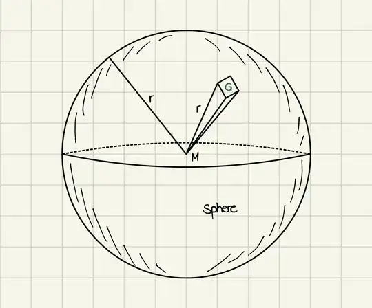

Let us consider the following sphere of radius r with an inscribed pyramid with base area G:
We can calculate the volume of the inscribed pyramid as follows:
$V_{pyramid} = \frac{1}{3} \cdot G \cdot r$
Notice that we can now express $V_{sphere}$ as the sum of the volume of infinitely small pyramids over the total surface area of the sphere, whereby $A_{sphere} = 4 \cdot \pi \cdot r^2$. When doing so, we get the following result:
$V_{sphere} = \sum volume\:of\:pyramid \\ = \sum \frac{1}{3} \cdot G \cdot r \\ = \sum \frac{1}{3} \cdot (4\pi r^2) \cdot r \\ = \frac{4}{3} \pi r^3$
So what do we take from this? The factor $\frac{4}{3}$ can be intuitively considered as a composition of the factor $4$ deriving from the area of the sphere and the factor $\frac{1}{3}$ coming from the volume of a pyramid.
The sphere can be split into many different pyramids. I will therefore start by showing why the volume of a pyramid is ${\tfrac{1}{3}}$Bh:
Then, the sphere is split into pyramids as follows:
The red sphere below has been split into very thin pyramids:
