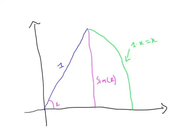

A simple draw : $$\ \ \ \ \ \ \ \ \ \ \ \ \ \ \ \ \ \ $$

In the diagram below (borrowed from this answer), we have:
  • $\sin(\theta) < PQ$, because $PQ$ is the hypothenuse of the right triangle $PQR$,
  • $PQ < \theta$, because $PQ$ is the shortest distance from $P$ to $Q$,
and so $\sin(\theta) < PQ < \theta$.
