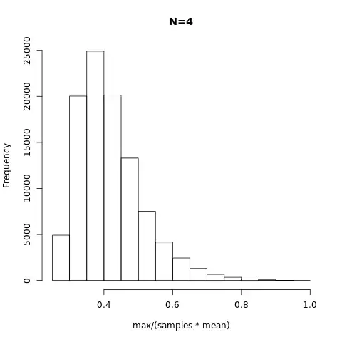

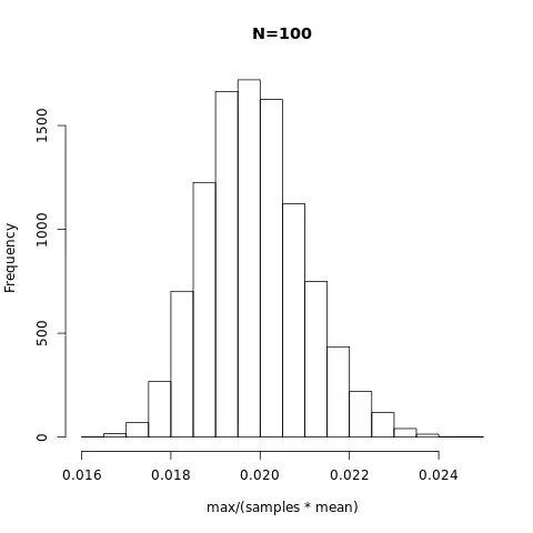

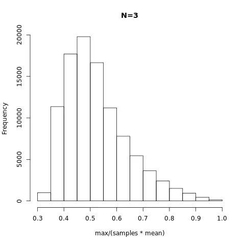

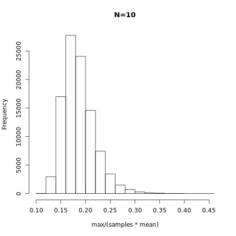

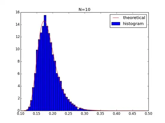

If this is any help, here are some simulations of the density.
CommonerG

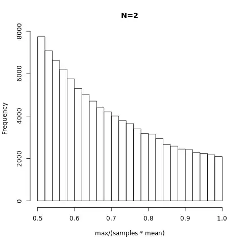

n=2

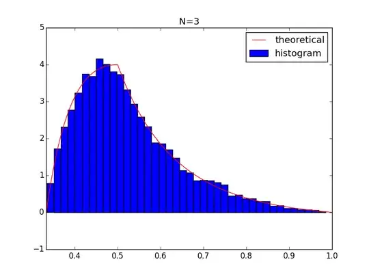

n=3: $$ P(\theta)=\left[P\left(\frac{z_1+z_2}{2}=\frac{1-\theta}{2\theta} \middle| z_1,z_2 \sim Unif(0,1) \right)\right] \frac{1}{2\theta^2} =\left[2-4*\left|\frac{1-\theta}{2\theta}-0.5\right|\right] \frac{1}{2\theta^2} $$

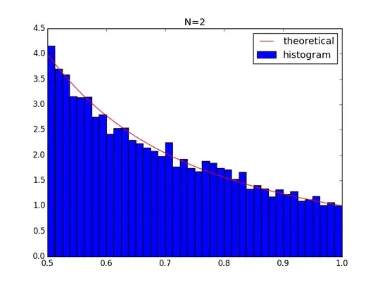

n=3

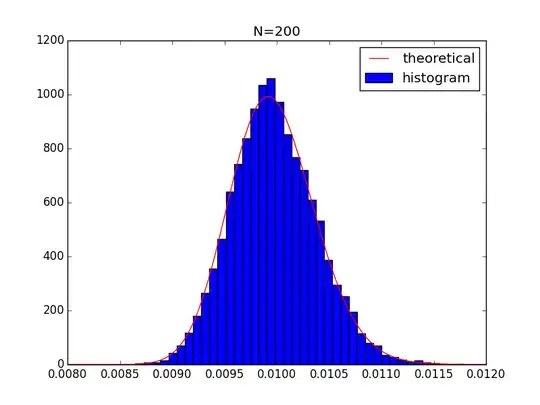

When $n$ is large, from central limit theorem, we know that $$ P\left(\bar{z}=\frac{1-\theta}{(n-1)\theta} \middle| z_i \sim Unif(0,1) \right) \approx P_\text{Gauss}\left(\frac{1-\theta}{(n-1)\theta}, \mu=0.5, \sigma^2=\frac{1}{12n}\right)\\ =\sqrt{\frac{6n}{\pi}}\exp\left[-6n\left(\frac{1-\theta}{(n-1)\theta}-0.5\right)^2\right] $$
With some approximation $n\gg 1$, we can write down the form more neatly as $$ \lim_{n\to \infty}P(\theta)\approx \frac{1}{n\theta^2} \sqrt{\frac{6n}{\pi}}\exp\left[-6n\left(\frac{1-\theta}{n\theta}-0.5\right)^2\right] $$
n=10 n=200
MLE with large n The value of maximum probability density is approximately $$ \frac{1-\theta}{n\theta}=0.5 \Rightarrow \theta=\frac{2}{n} $$
