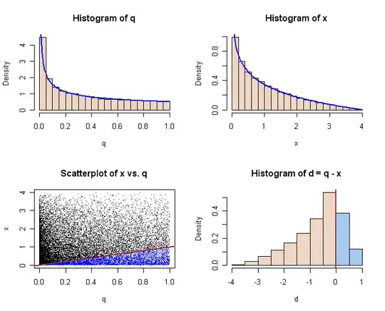

The following figure is based on 30,000 simulated equations. Histograms of simulated values of $Q$ and $X$ show the theoretical density curves. The brown lines in the scatterplot and histogram of values of the discriminant $D\,$ separate equations with real (blue) and complex solutions.
