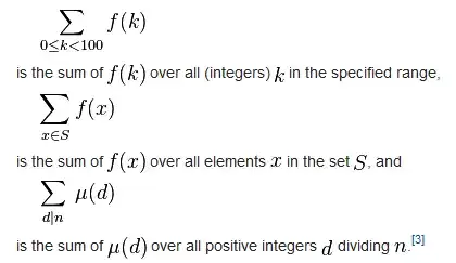

No, summations do not always increment by one. In fact, summations can be over many kinds of sets, possibly not even restricted to integers or countable cardinality. Some examples from Wikipedia:
Summation examples
An example of a proof involving a summation over an uncountable set can be seen here on SE: The sum of an uncountable number of positive numbers
  • Your answer is misleading. As the second answer to the question you linked to states quite clearly, one is allowed to write a summation only when (one has shown that) the specified criterion holds. Otherwise it is not even meaningful, such as "$\sum_{x \in [-1,1]} x$", which cannot be assigned any meaningful interpretation. – user21820 Jan 30 '16 at 05:34
    @user21820: I changed "any arbitrary set" to "many kinds of sets"; thanks for the suggestion for improvement. – Daniel R. Collins Jan 30 '16 at 06:05
