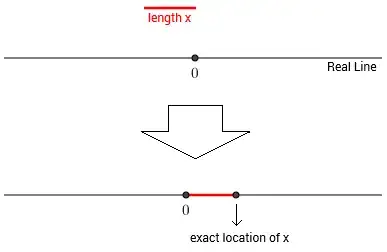

Because of your edit, I will consider the following question:
Can we determine the exact location of the points $\pi$ and $e$ in the real line?
Assuming we know where the number zero is in the line, we can determine the exact location of a number $x$ if we can construct a segment with length $x$.

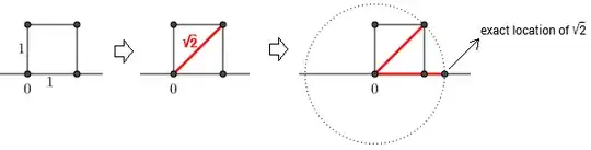

For example, we can determine the exact location of $\sqrt{2}$ because we can construct a line segment with length $\sqrt{2}$. For this, draw a square with side $1$ and then draw its diagonal. The diagonal is a segment with length $\sqrt{2}$.
So, the answer for our question is: No, we can't determine the exact location of $\pi$ and $e$ because we can't draw segments with these lengths.
But why not? Because $\pi$ and $e$ are not algebraic numbers while a constructible number must be algebraic.
