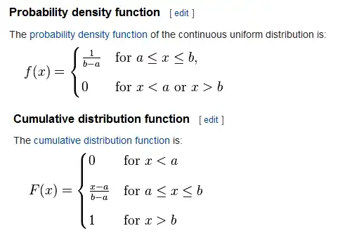

  • You are missing a Jacobian in the transformation of (continuous) variables. Density of $U(0,1)$ is twice that of $U(0,2)$ - so while each particular $x$ has zero probability in both cases, these zeros are of different orders - one is twice as large as the other. – A.S. Dec 24 '15 at 00:35

    You cannot mix and match Discrete Probability Distribution with Continuous Probability Distribution. Let me ask you these two questions:
    1. What is the probability that a randomly chosen number between 0 and 1 is exactly 0.278?
    2. What is the probability that a randomly chosen number between 0 and 1 lies in the range 0.45 to 0.60?
    – Masked Man Dec 24 '15 at 06:07
