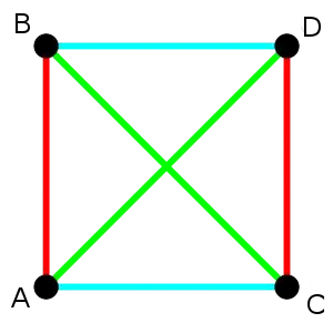

Finite affine plane of order 2, containing 4 points and 6 lines.
In this geometry we have 4 points A, B, C, D and 6 lines AB, CD; AD, BC; AC, BD. The families of parallel lines are separated by semicolons.

    What do you mean by "interpret" that isn't already contained in the description of the question? One can think of these as the (affine) lines in $\Bbb F_2^2$, and hence identify this geometry with any affine chart for the Fano Plane, $\Bbb P (\Bbb F_2^3)$ – Travis Willse Dec 24 '15 at 03:51
So, now the base field, i.e. the number line instead of all the real numbers, consists only of $0$ and $1$, with $1+1=0$.
It is stated that the plane over this $2$ element field has six lines. Later those equations are just the equations of these 6 lines.
For instance, we have $A=(0,0)$ and $B=(0,1)$, and the line $AB$ is the one with equation $$X=0$$ and indeed, these two points satisfy this equation.
Or, take $AD$ with $D=(1,1)$, both points satisfy $X+Y=0$.
And so on.

The equations describe the lines, that is, if a point satisfies the equation then it is on the line. For example the line $X = 0$ is satisfied by all points $(X,Y)$ with $X = 0$ (with the coordinates $X$ and $Y$ coming from $\mathbb{F}_{2}$, the finite field of order 2). This gives an algebraic way to describe the lines.
You can think of the lines as having a slope of either $0$, $1$, or $\infty$ ($Y$ coefficient divided by $X$ coefficient), these slopes determine your parallel classes. This should let you go from a pair of points to the equation by determining a slope and then using a point to get the remaining value to describe the line as $AX+BY=C$.
