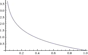

You can see why this makes sense if we plot -log(x) from 0 to 1:
we get a corresponding range from <span class=$\infty$ to 0">
i.e. if y = 1 then the cost goes from $\infty$ to 0 as the hypothesis/prediction moves from 0 to 1.

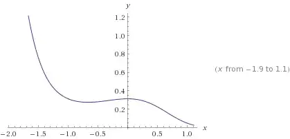

Here is an example of a hypothesis function that will lead to a non-convex cost function:
$h_\theta(X) = sigmoid(1 + x^2 + x^3)$
leading to cost function (for y = 1):
$-log(sigmoid(1 + x^2 + x^3))$
which is a non-convex function as we can see when we graph it:
non-convex
